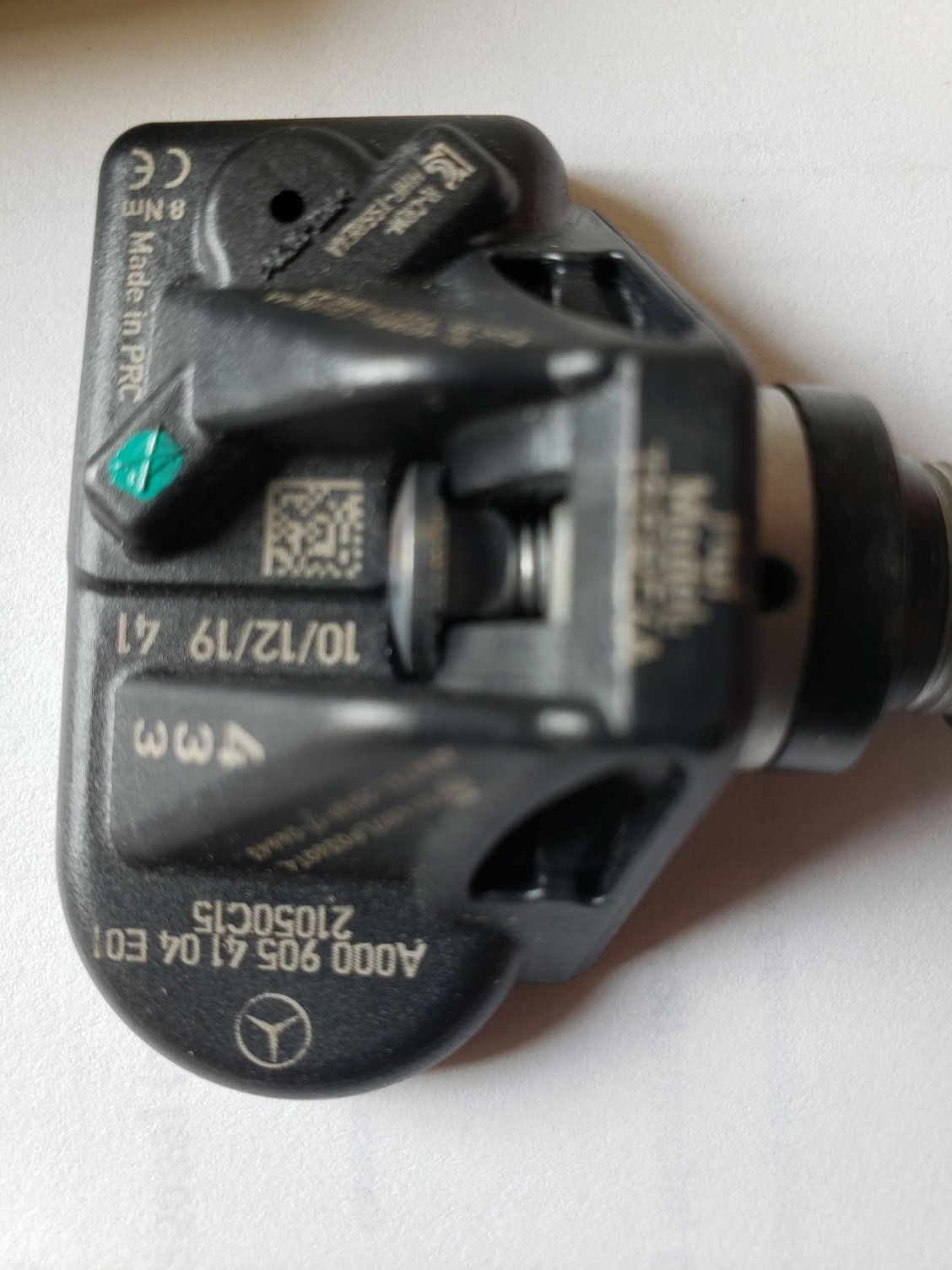

Originally Posted by takkie
ummm... Do you have a link to the MB one? Tried googling but not entirly sure which one is the right one.
thanks
Here is a pic of mine.
TPMS Sensor - Mercedes-Benz (000-905-41-04)
