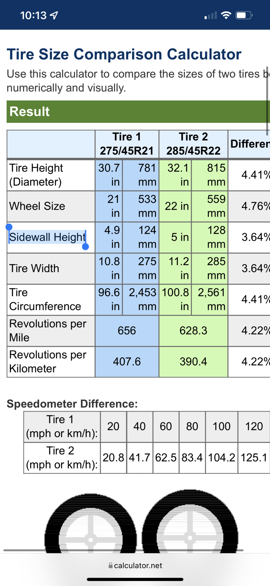

Almsot always true, but the GLE and GLS are interesting cases. The GLE has smaller tires on its 19 inch wheels (255 50 R19 and 275 50 R20) and the GLS has bigger tires on the 22 and 23 inch wheels. For the GLS:
275/55/R19
275/50/R20
275/45/R21 and 315/40/R21
285/45/R22 and 325/40/R22
285/40/R23 and 325/35/R23.
So the 22 and 23 inch wheels have tired about an inch bigger then the tires on the 19s, 20s, and 21s, and on the GLE cars with 19 inch wheels have tires about an inch smaller then on the 20s, 21s, and 22s.

Wow, that is very interesting and while double checking that the tire diameter of the 22” is larger (i.e., 1.4” larger) I discovered that because of this the sidewall height for the 22” wheels is actually larger than the sidewall height for the 21” wheels. As seen in the picture below the 21” stock wheels have a 4.9” sidewall height and the 22” stock wheels have a 5” sidewall height. This is particularly interesting because the sidewall height effects the smoothness of the drive by providing more tire cushion. So I guess in theory the 22” wheels should NOT have a harsher ride than the 21” wheels which is counterintuitive.

Wow. First time I've seen that. Pretty much every car I've had or researched kept the same tire height between different wheel sizes.
