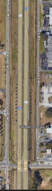

We have more than one local road where the speed is 75 and the car thinks it is 55 or 65. One road in particular that is next to I75 (where the limit is 75) the car says it is 75 and it is really 30.....if you look at the map it makes sense....
