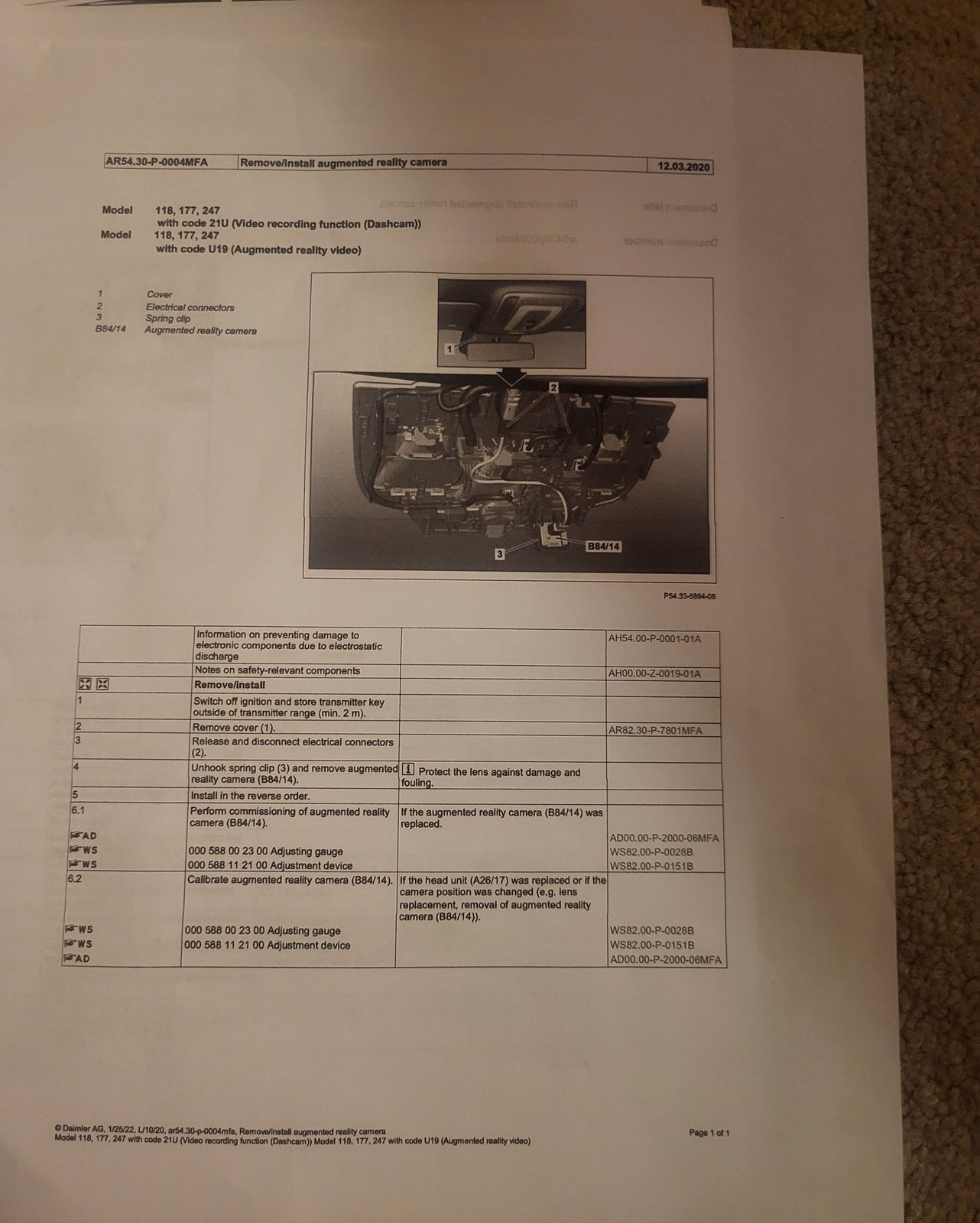

Headunit swap
Originally Posted by z28lt1
None of the recently built/delivered cars are getting AR. Most seem to know ahead of time, surprised your dealer didn't.
AR should be the camera, mirror/housing assembly, probably a wiring harness and it actually comes with a higher end MBUX with a better graphics processor. It all depends upon what parts your car doesn't have at the moment. If it is none of them, it's an expensive and probably somewhat labor intensive effort to swap all of that out and I'm sure MB doesn't want to spend $1000's to get you a $350 option. Easier for them just to say no. That MBUX system swap (if required) isn't going to be cheap in parts or labor. Ask your dealer to provide you with the build sheet/codes. If you have 548, you don't have the proper MBUX system for AR. If you have 549, at least that is taken care of.
Think I saw a post somewhere (maybe GLE section) where someone in Europe said they were told it could/would be added later, so not sure if that is a mistake or if possible their vehicle is closer to the "right" parts than the US cars.
actually I have Mercedes-Benz c118 headunit ASRA TAKES 2 HR not that much time and canera .5 hr and the rest program i forget but I think less than .5hr . ASRA which is what Mercedes-Benz users to bill hours tell you how long s job should take its bs if you ask me . They have been having issues with headunit corruption hardrive etc and have had replace do for them say they can't is bull****. I'll just force them upgrade to 549 by complaining about the errors.

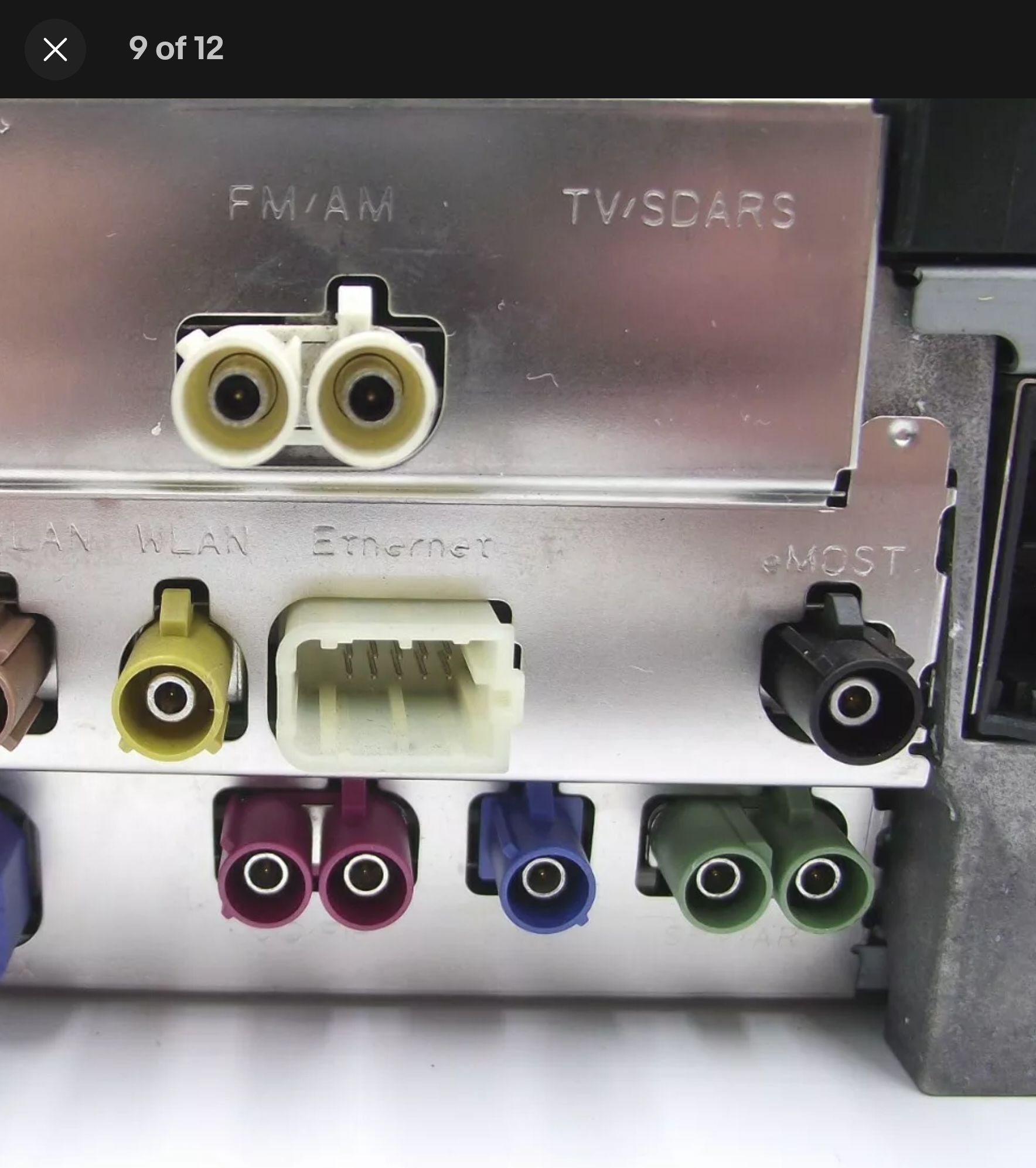

Hey all- I see that RJ Automotive in the UK is selling a retrofit for the 548. Has anyone done this yet?
http://www.rjautomotive.net/products...h-retrofit-549

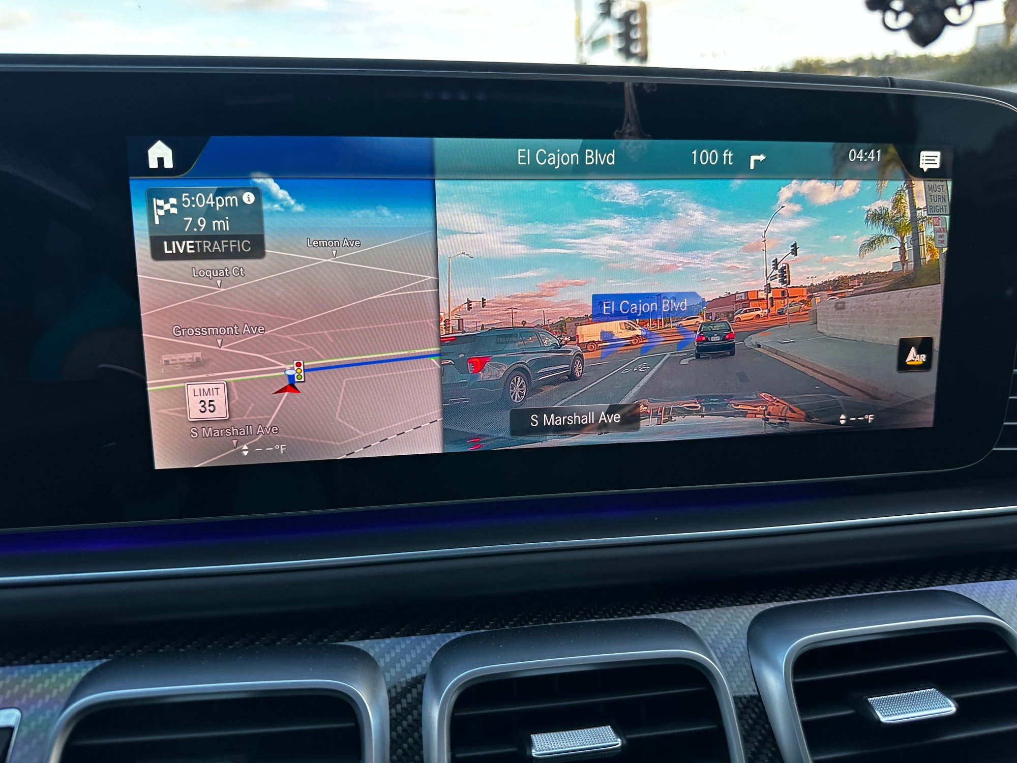

Old Mar 4, 2024 | 10:35 PM
Rani Sawa's Avatar
Joined: Feb 2024
2021 GLE63S AMG COUPE
Installed Augmented Reality camera
I have Installed Augmented Reality camera on my 2021 GLE63S COUPE.
I am In USA,
so i have purchased my Mercedes with out the Installed Augmented Reality camera and i was looking and asked all the dealers around and they said no way can be added ,
Thanks you guys for the big help that made me insist to see who i can make it happen.
so I looked at my window sticker and my vehicle it’s showing that it has code 549 , and I called the dealership with providing them the vin number, they have confirmed the vehicle has code 549 so they told me that only thing I need is by the camera kit , witch is the camera and the harness wiring, so i ask him if its available, he said Mercedes part doesn’t sell this kit , it has to come with a vehicle.
so i did more searching and you guys said RJA has the kit available , so he actually has 2 kind of kit’s with 549 code options or with out , witch is the vehicle will have 548 code witch is you can buy the complete kit with the MBUX HIGH Retrofit ,
So ones i have 549 code I thought i can find the kit somewhere use , i did me research and found in auto part on Ebay selling a kit i need for my car as i said
i need the camera and the wire harness kit , so i called my dealer service advisor and told him i got the part so he did the search and he called me back an said they can’t install it at the dealer and he did refer me to in audio store, i called them they said they never had done in this model before.
so i called the dealer back and he talked to technician
some how to help me , so they finally told me to take my vehicle to them they will install it . He said if i do throw the dealer it will cost me $1,500 to install with out the calibration ( programming ) if needs it , or $700 if the technician do it as a side job , so i agreed to do on side for $700 and luckily it didn’t need any calibration.
it’s working great and doesn’t need anything else.
I am happy to have it on my v
ehicle
