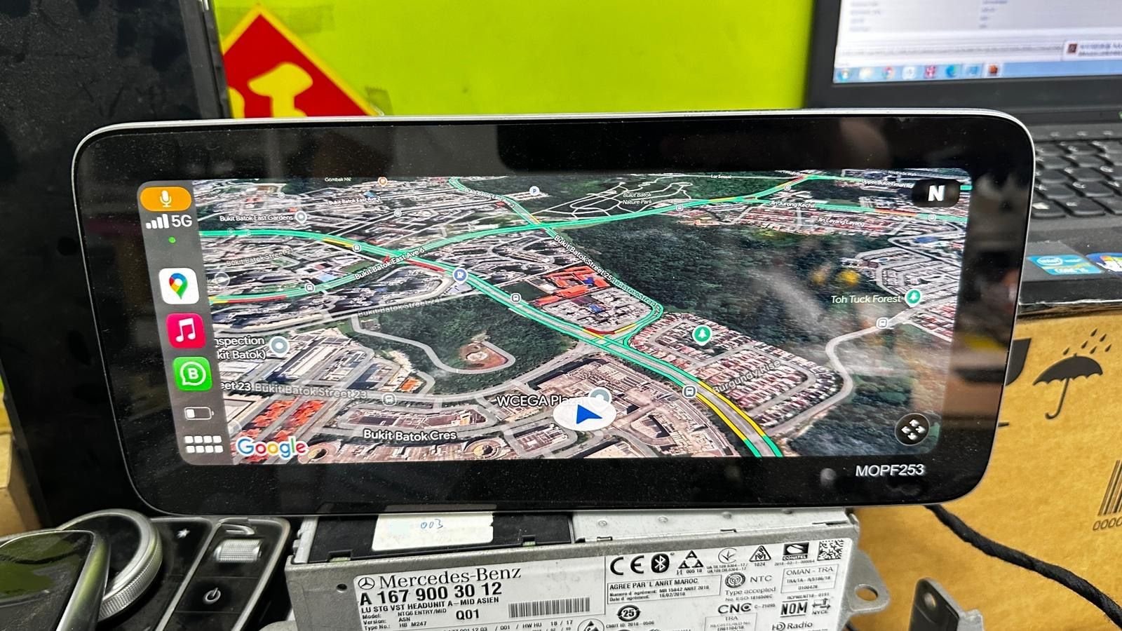

I have some exciting updates:
1. As I mentioned above, the KSmart unit ended up being a bad experience (bluetooth call issues and frozen screen), and customer service didn’t help either. Aliexpress stepped in and refunded me.
2. I got an update from @EleBest about the request I referenced above to him if he has something to offer. He already got a solution that will work for X167 or any NTG 6 and newer MBUX units that he worked on this week with success. He sent me photos from his lab/office setup and said he got a factory-walkaround solution for CarPlay Full Screen. It also involves unlocking all high-end MBUX-high features like Augmented reality and full map on cluster if it’s not on the car already. CarPlay full screen is my priority anyway. I am getting that setup and he said the items will ship to me via Fedex or DHL tomorrow and he will also do coding later this week. I know nothing about it yet, but will report back. He sent a video but I don’t know how to post it here, seemed as smooth as factory. He said resolution matches the highest resolution of the screen itself so no clarify issue. I’ll keep everyone posted as I try it out but am excited:
Photos the Elebest sent me for his solution:

FINALLY, I had the time to install everything over the weekend! I am speechless—everything feels and looks like it came straight from the factory:.
1. CarPlay is displayed at full resolution/clarity of the screen
2. It also made CarPlay wireless. I can even see the factory/setting window for CarPlay wireless (I’ve attached a photo).
3. It is accessed the same exact why as factory carplay and show up as such in the MBUX. All buttons and shortcuts also work including music swipe etc.
4. There are factory AC temperature, air conditioning, and sound toggle windows that appear when changed and then disappear (I attached a photo)
5. With the pre-coded OEM parts he sent me, I also received high-end MBUX specifications and features. Once I installed everything, CarPlay full and wireless worked immediately. However, he also coded full-screen MBUX maps onto the driver’s display. If I get a camera, augmented reality is also enabled. He also coded it to allow carplay text while driving, and also coded it to allow MBUX and CarPlay maps navigation to both work/navigate at the same time if needed.
I’ll thoroughly test the carplay unit for about a week before sharing more. Once I’m done testing, I’ll also take installation photos and share them. I’ll likely start a new thread by then to avoid confusion because the other carplay unit in my first post was an aftermarket unit from an online seller, unlike this OEM modification from Max. This guy is a genius! Thanks a lot, @EleBest !!!
Quick photos. I’ll post more and write a detailed thread as I test it further. So far, it’s acting as expected, just like I’d imagine if MBenz had done it.

I think this video gives you an idea of where the device needs to be installed, under the front passenger seat:
(disregard the device advertised in this video though)

Originally Posted by sadie_s
Thanks for sharing, this is great news. I’m really looking forward to your detailed write-up. I’ve been in contact with @EleBest and am in the process of purchasing. I’ve just recently purchased my GLS and this is my first foray into anything like this. Any tips for beginners would be helpful.
Originally Posted by adisco93
@W-222 Looking forward to doing this as well, but have no DIY experience. On a 10-point scale of difficulty, how would you describe this? Also, slightly confused about your point on MBenz, did the hardware also have to go to Mbenz when it left @EleBest Can you clarify? Patiently waiting on your detailed write up.
YOUTUBE link above
You guys are making me feel really bad for not yet finding the time to write a detailed installation instruction with photos I have taken (sorry about that). I was hopping to dedicate 30 min this weekend but truly couldn't and it's not something I can draft from my phone like I do when scrolling through the forum in my free time.
I promise to do that this weekend. I've been too busy with work, and during my free time am searching for a new toy : ) (new car).
Anyway if you must get help for installing the unit now, the video that Wildta shared above is exactly what you wanna do to get to the headunit (except that you don't need to worry about that chinese box they are showing) - ignore that. For the solution that Elebest sent me, once you get to that area, all you need to do is to remove 3 screws around the MBUX unit (it's that large silver device), and then move the cables one by one from the old unit, to the new headunit. It's plug and play with same exact ports, so all your cables would just relocate to the new unit exactly the same way. Then of course put the 3 screws back so that the new headunit is secured in same place as the old unit, and take your unit then and keep it save as a back up : ) or sell it on youtube if you like.
And no, you do not need to go to Mercedes-Benz after you install it. Elebest signed in remotely and made the car aware that it has a new headunit now. I then downloaded fresh-new maps in a flash drive (free through Mercedes Me app but also Elebest also sent me a direct pre-paid link though again it's free to US users in the US through Mercedes Me). I promise to share my installation photos with step by step instructions this weekend.
Under the passenger seat is totally doable. I'm glad you don't have to rip the dash apart, that would definitely be a deal breaker for me!
Old Nov 11, 2024 | 02:14 PM
  #48
S_W222's Avatar
Joined: Sep 2019
Posts: 3,129
Likes: 1,507
From: U.S.
Current/Last 5-years:GLS;G70;Alpina B8;X7;Accord. Sold:X7,TeslaS;S560;S550,X5;530e;L.Navigator;LS460
You don't but there are a few steps that the video provided intentionally ignore to make it look easy, which i was trying to explain when I write my full detailed installation info. This is related to the B biller (bottom portion), you really need to get that removed (just pop it out, it has clips) so that then you can remove the carpet (cause part of it is tucked under the B biller).
Also, my suggestion is to remove the negative terminal from the battery which is right under the driver seat and u can access it from behind. The negative terminal is easy to access. Just safer to play with cables when car is 100% off.
Last, do not remove the seat belt - no need to do so. Just remove the seat outside the car and pull the seat belt and tuck the car seat as far as u can setting on your garage so u can freely access that area under the seat.
