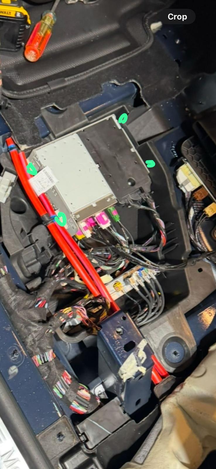

OP back here… Sorry I’ve been absent for a few weeks (spent the entire month of Nov shopping for me new Alpina and finally found it, so not much free-time left for forums or Mbenz forums honestly lol). December now, and am on a vacation with family for 3 weeks.
Yes, from my experience / understanding, the dongle serves two functions: maintain the full screen carplay to always survive any dealer changes or forced-updates so that full screen function is never lost no matter what; 2nd, it facilitates wireless connectivity and quick auto-startup for carplay.
For LTE connectivity, to clarify: I didn’t lose any connectivity (remote function still work, and all other features work just fine). The only thing that won’t work is (Hey Mercedes). If you are a CarPlay user, obviously no android auto for you which was well communicated in advance. Also, for LTE in case I needed it, Elebest sent me info to share with my dealer if I ever decide to get LTE back but I never bothered cause I never cares about (Her Mercedes) feature. He got me in touch with someone from NYC who managed to get his LTE connectivity work by passing instruction to the dealer to update their system (data card?) to see the new OEM headunit. That person was kind enough to share his experience and said it worked. I still have no plans to get LTE as I don’t use (Her Mercedes). Also, my headunit came already with most recent OTA MBUX update installed on it.

For those who were asking me to post more info about installation : this is what you see after you remove the passenger seat, and remove the plastic and carpet underneath the seat. The headunit is right there. I drew 4 light-yellow circles where you’ll find 4 screws. You just need to remove these screws, move all the cables from the old to the new headunit, and you are done.
By the way, thanks to some of the users above who noted that there was a puppet account hijacking this thread. I also reported the puppet and the easy to know “parent” account are both gone. Thanks to the responsive mods.

Originally Posted by Wes199999
Do you have any updates? Will they be shipping the entire screen or just a box? I’d buy it instantly if the “Hey Mercedes” feature still works. Does the standard Mercedes navigation system remain functional? For example, can I still say, “Hey Mercedes, take me to _____”?. Can I get OTA updates? Thank you for your writeup.
The answers to all your questions are in the posts above if you can spend the time reading through that. However, I'll provide quick answers..
Updates? yes it works, flawless, no glitches after few months already with it now. Again read the last few posts; it's the MBUX solution from Elebest not the unit I first mentioned in post #1. Does the "Hey Mercedes" work? You can make it work, by asking your dealer to activate the new OEM MBUX unit, otherwise everything will work except this feature.
Does standard Navigation remain functional? Yes, Elebest provided me a code to activate the maps for the first time, and then I also downloaded the most recent version of maps from the mbenz website he shared. In fact, navigation now works better than before because with the new MBUX high-end unit, now I can do full screen map view on the driver screen. Additionally, I can activate MBUX navigation on the driver screen with apple map navigation on the other one, both activated/routing.
Additional benefits I noticed?
1. MBUX high-end is faster than my previous med-spec MBUX.
2. I can now use the keyboard "type location" inside of Apple Carplay while driving when searching while driving (was not possible before that). Make sure to ask Elebest to activate that just in case.
3. CarPlay is also Wireless now. You can still use the regular wire-connection too.
4. You will keep your other MBUX unit (good for redundancy). If anything happens (sell the car?) you can swap out the older unit and get it installed again and keep your high-end MBUX unit. They are selling on ebay for almost a thousand dollar so you can sell it later in the future.
5. Car should be have Augmented-Reality (AR) and dashcam capability now. If needed, you'll need to buy the OEM dashcam and wire it in. Seems like an easy job, but I decided to skip (I have my own dashcam, though AR would have been nice)
Good luck....
