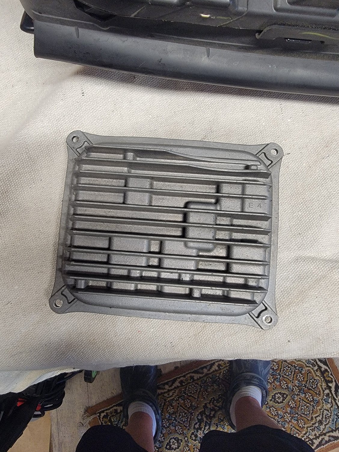

I removed my headlight assembly and found there's a module on the side and on the bottom and my problem is my DRL doesn't work however the turn signal still blinks Amber which uses the same LED strip.

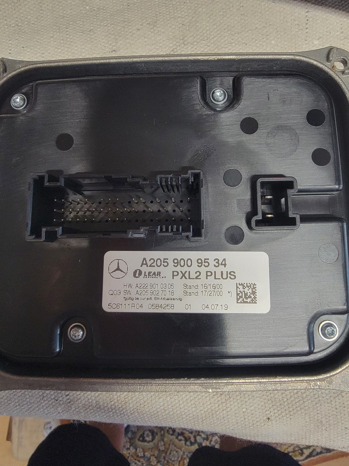

DLR is the PXL one

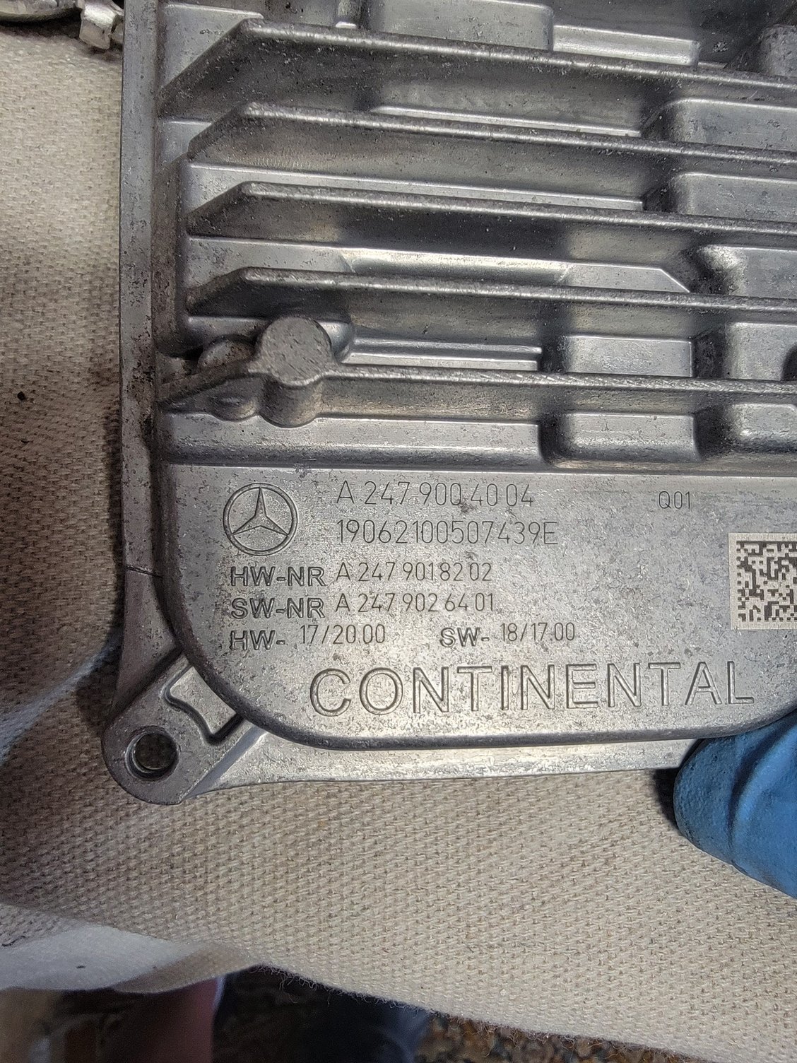

This one? This is it it helps me out a lot because they're replacement module I ordered from eBay didn't fit either of the module locations and they're willing to send me a replacement but I have to know which one it is in my headlight.

Well I replaced the pxl2 module today and no change. Dam

Of course as ninja gave you wrong answer for a reason. "PXL" came from Pixel that controls the main/high beam. HLI is the one that control the DRL

PXL is the LED Matrix Module. But the Matrix represents the multi LED for main/high beam

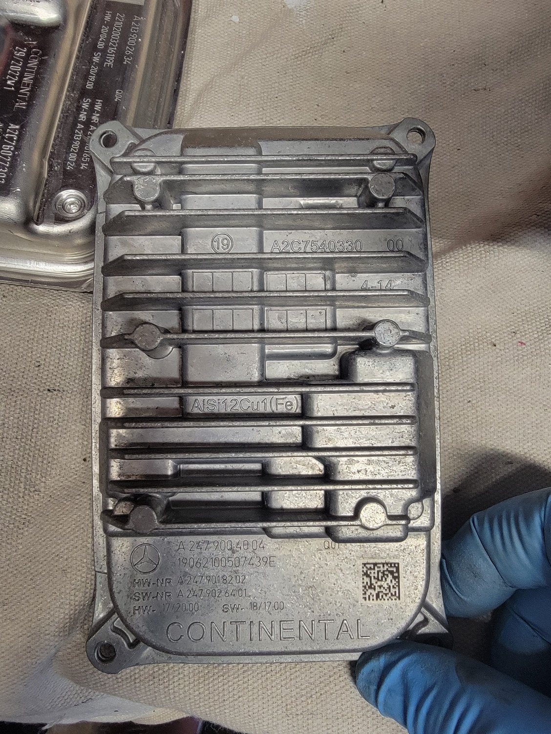

I have a new "continental" module coming in about a week. If its not that I guess its an issue in the headlight DRL strip itself.
