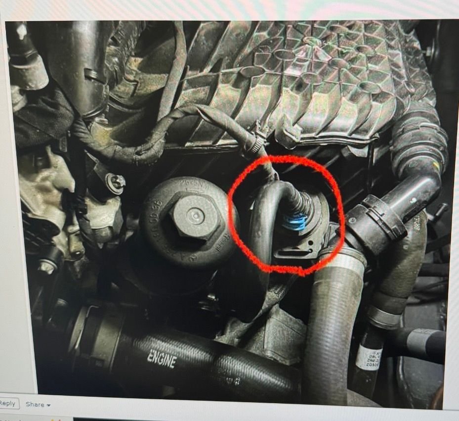

Dec 5, 2025 | 09:03 PM
Quote: Sorry, I meant in the engine compartment. I’m kinda hard of hearing and can’t find the location of the faulty part.
oh ok; just look at the driver side of the engine, right under the air intake. See attached.

Dec 5, 2025 | 09:11 PM
Quote: oh ok; just look at the driver side of the engine, right under the air intake. See attached.
Oh, I apologize. I have a M176. I can’t find this thing lol.
