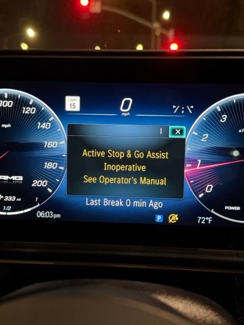

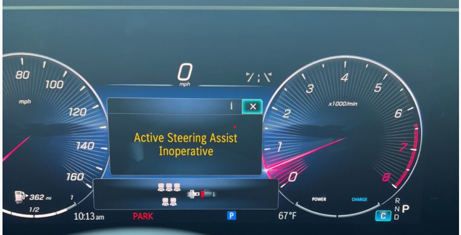

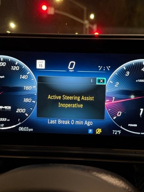

Active Steering Assist Inoperative
I am getting this kind of messages soon after i start mycar this morning anyone faced this issues ??what are my options .??
anyone know the possible cause ??
