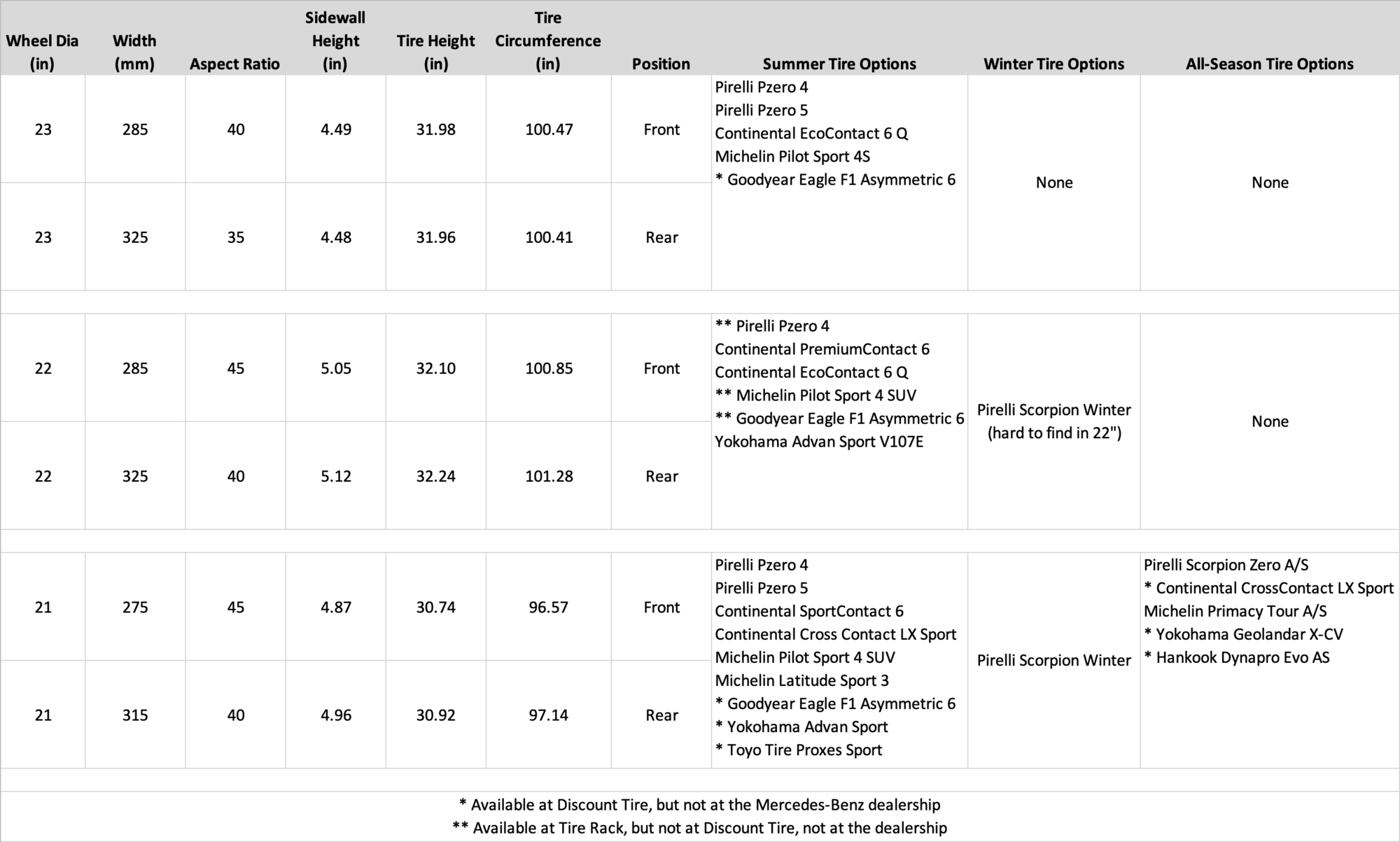

Tire availability for 23" 22" 21" wheel options
I pulled the data from these 3 sites:
https://www.mbusatirecenter.com
https://www.discounttire.com
https://www.tirerack.com

Originally Posted by Missourian
Very helpful. Thank you for sharing. I just got another set of 22 PS4S but I was considering the Goodyear because of the price.

My favorite winter tire, the Nokian R3 SUV isn't on that list. It does come in a staggered 21-in fitment, so that must be a list of MO and MO1 designated tires.
I don't think there's a non-studded winter tire that's in the same class as the Nokian.

This list is broader than MO and MO1, but contains only OEM dimensions. Where did you buy the Nokiens and did you have to use non-OEM dimensions? Tire Rack typically carries every tire on the market and they don’t offer the Nokians in OEM dimension.
You really did it.
Thanks for this
So just to be clear, I have the 23's on my 580, I can get OEM 21's without fitment issues to get a winter or all season ? Any impact on speedometer doing this ?

All three sizes have very limited tire selections. I run 20"s on both my G550 and X7 M50i to keep my life simple and affordable.

Originally Posted by lungs414
You really did it.
Thanks for this
You will need to check with your parts department. My dealer tried 21" on mine with AMG line but I believe that the tires rubbed. 22" should work, but it's such a minimal change that I haven't moved forward with it.
Plus I don't need winter tires in Florida, but I would like All Season tires. Of course, there are none for 23" or 22".

Per the Discount Tire size calculator (Discount Tire and Costco were the 2 largest customers of the major tire brand I worked for), going from 23" OEM tire size to 21" OEM tire size will mean when your speedometer reads 65 mph, your actual speed is 62.9, a 3.3% smaller tire. I'm not sure how these cars compensate the speedometer, but there's definitely a way to do it.
When a tire is mounted, it doesn’t match the tire size calculator because there are more parameters that go into a tire’s carcass size than the 3 listed in the published sizing, so take the calculator results with a grain of salt. Even a different model tire within the same brand can be listed as the same size but the actual physical size can be different.
https://www.discounttire.com/learn/tire-size-calculator
I've bought Nokian's from Discount Tire, Big O, Simple Tire, and my local tire store.
21's were available last fall, but I don't see any rears right now.
Availability can limit what is seen on websites, and in late summer there may not be many winter tires available, in any size, from any manufacturer.
I don't really like Tire Rack, except for their reviews on YouTube, which can be excellent. I was hoping for an improvement after Discount Tire bought Tire Rack, but I haven't seen much change.
Simple Tire seems to be the most knowledgeable about Nokians. Or my local store, where their counter guy used to work for a Nokian Distributor.
Some members have mentioned the ability to change tire sizes using an OBD2 diagnostic tool on other MB models. Perhaps a coder can chime in like @EleBest or forum member @S-Prihadi who is well acquainted with those OBD2 tools.

Can it be possible that
Hankook Dynapro evo AS (RA21) 315/40ZR21 115Y XL
are only $294 per tire ?
I'm interested in them but cant find any reliable reviews for them.
I am going with 21" wheels to get an all season tire.
But I see the fronts would be
Hankook Dynapro evo AS (RA21) 275/40ZR21 115Y XL only not 45
Anyone know what problem if any this would present ?
You can not do what you are saying. The options are based on how the car is ordered
once a car fits the 22 or 23 in tires.. its tunned dor that wheel size...
if you downsize... the calculator has to bee based on the original size..
so no you can not fit the 21 in tires on the 23 in tires...

I think this is a lost in translation issue. I may be wrong but what I think he is attempting to say is that you cannot put a 21" tire on a 23" wheel which is in fact correct obviously.

Changing wheel and tire size can take some time using a tire size calculator to find close circumference matches and widths that won't rub, and then checking the tire brands and models to see what size are available. But it's possible to find a combination that works. I downsized 22" staggered run-flats on my X7 to 20" squared-up non run-flats, staying with the original front tire spec width and ended up with less than 0.5% circumference difference. On my G550, I upsized slightly from the OE 275/50R20 to 275/55R20 in order to mount an A/T 3MPSF tire I wanted. This imposed a 3% circumference change and a consequential speedo/odo error. Circumference changes can be corrected if you have access to the right equipment. I have a Topdon OBD scanner that provides tire size change coding for several car brands, but unfortunately not MB. I briefly played with what I thought might be tire size variant coding on my Launch OBD scanner, but without success.
