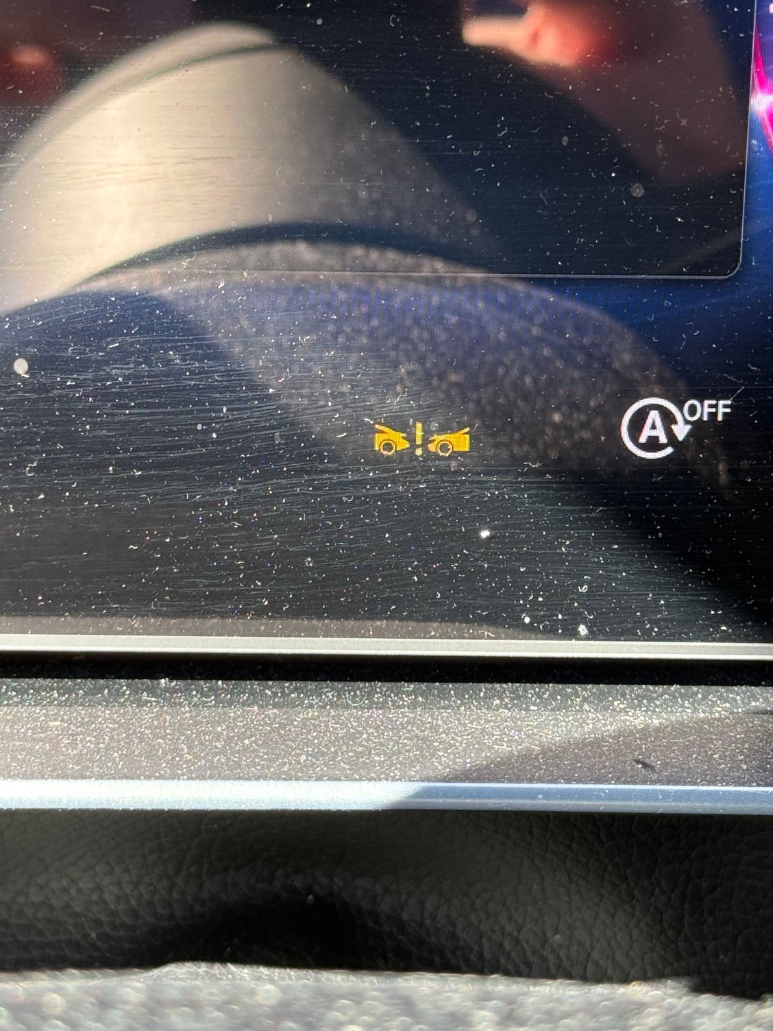

I see this when I start it but don’t see it while driving. Active assist  I think. Does this mean there is a problem ?

Depending on when you see it, it's probably a system check showing you that the light works.

Thanks for the response. But it seems weird that it’s the only light on. I may go down to the dealer and see if I can ask them.

Forward collision warning and emergency brake assist is off when you see this. Actually in your case I think it's indicating a malfunction. If the word Off is also displayed above it, then it was deliberately turned off, but without that I'm pretty sure it means malfunction.
Yep, here's what I see if I turn off ESP in my car, which then also turns off the forward collision system. Notice that it says Off in addition to the symbol you are seeing.

Yeah no "X" or word off. I wonder if it's a dirty sensor. We had crazy snow around here for the last week. I will check that first.

Definitely clean the sensor first

Depending on options, it could be the cameras by the rear view mirror being obstructed or confused as well.
