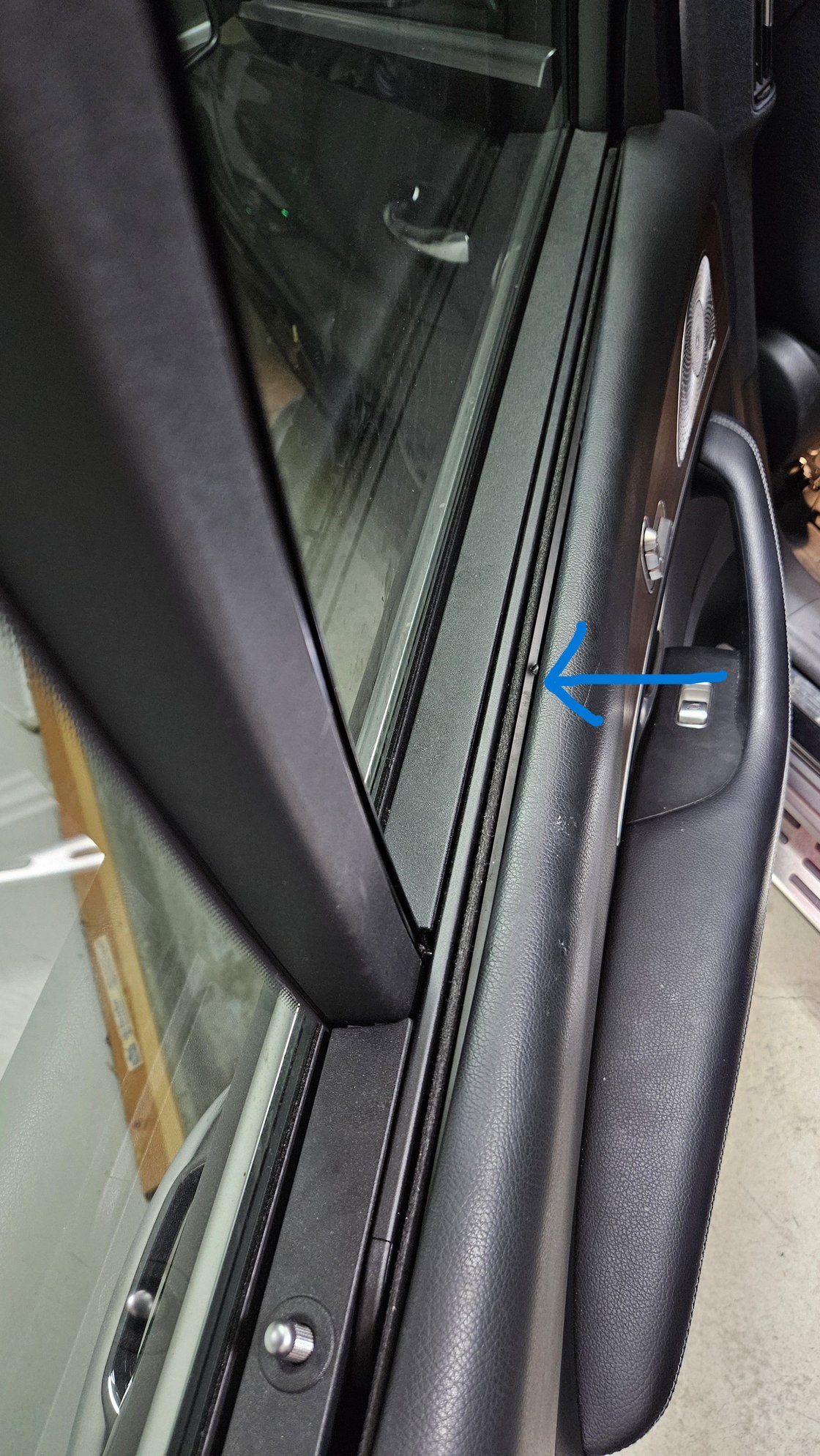

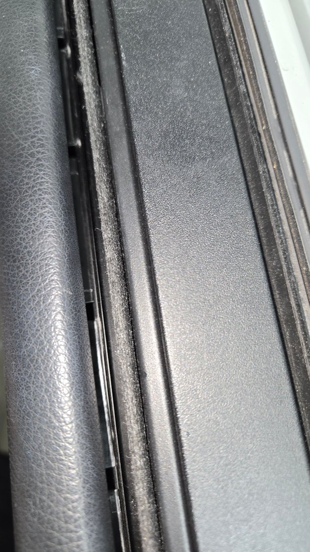

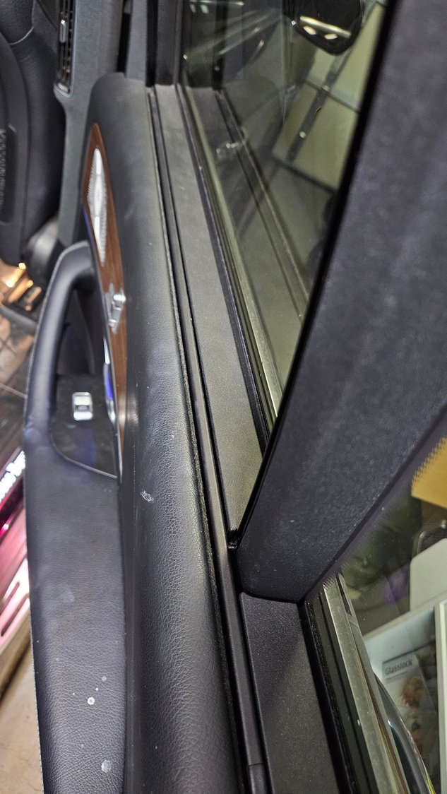

Rear Inner Door Panel Loose/Not Clipped in
Hi All,
I have a 2020 GLS with the sunshades and on my driver side rear door, the interior door panel trim is not tight fitted. You can see the comparison between the two photos that there is a gap on the left door, but if the panel is tight fitted on the right side door. I have extended warranty, but the last time I went in they said that interior trim is not covered under the extended warranty and was asking for a 3 hour diagnostic fee + any additional time/repair costs. I feel like this is going to cost me over $1k to fix at the dealer where it probably is a trim clip that might be broken or something that I can do myself.
I really need to get this fixed as my toddler is putting stuff inside and is starting to jam the sunshade. I've gotten the items out and it works properly for now, but I am curious if anybody would know for sure if this is covered under extended warranty. If not, does anyone have any instructions from WIS or have any idea how i can take the door panel off and hopefully replace a clip or something? Any insight would help.
Thank you!!

Common issue, I have the exact same setup with the sun shade too. If you’ve not done this before or not terribly mechanically inclined or just not confident about it, an easier way to fix it is to just go by a body shop or window tint place instead of dealership. Along the top there, the panel has a narrow slide piece that runs the entire length of the panel and sit right under the window. It has popped out of the rail. You can try pushing on it to see if it’ll clip back in.
this is the front door procedure, but is basically the exact same for the rear, minus the need to remove a piece under the handle (look, you’ll see the screw hole already exposed. There is a second screw hidden under the top corner of the handle, you have to pop off the same little piece as the front door in the video to access it. Around the lower and side parameter of the door are the clips. Get a trim remover tool from Amazon, slide it in between the panel and metal door and go around the parameter to pop the clips. Do not use a metal screw driver!!! Get the nylon trim tool, won’t scratch up the paint.

Thanks for the info, I will definitely try this out and see if I can get this fixed. So to confirm, I will need to take the panel off before I try to push the narrow slide piece back on the rail right?
I was just worried it wasn't a DIYable thing, but this seems simple enough. It would be nice if someone can locate the TSB related to this though, as I have also had no luck with finding one as well.

Well I did take off the door panel and the slide clips are going inside the rail, but its not really latching onto anything like someone above mentioned as well. It seems my door is warped (curving towards the inside of car near the middle of the panel), and it wont engage any thing. Since there's no real purple clip at that location, I think it's just going to be like this unless I replace the door panel unfortunately. If anybody have any further insights with a TSB or something, I think they will not cover me a door panel under extended warranty.

I brought the car in to another dealer that doesn't charge a diagnostic fee if my car has a ELW. Turns out it was an issue with the sunshade roller. Apparently there's a clip in the sunshade assembly that the door latches onto. They replaced it and so far it has not popped back out. Hopefully this fixes the issue and maybe it can help others with the same issue. Replaced for free under ELW.
