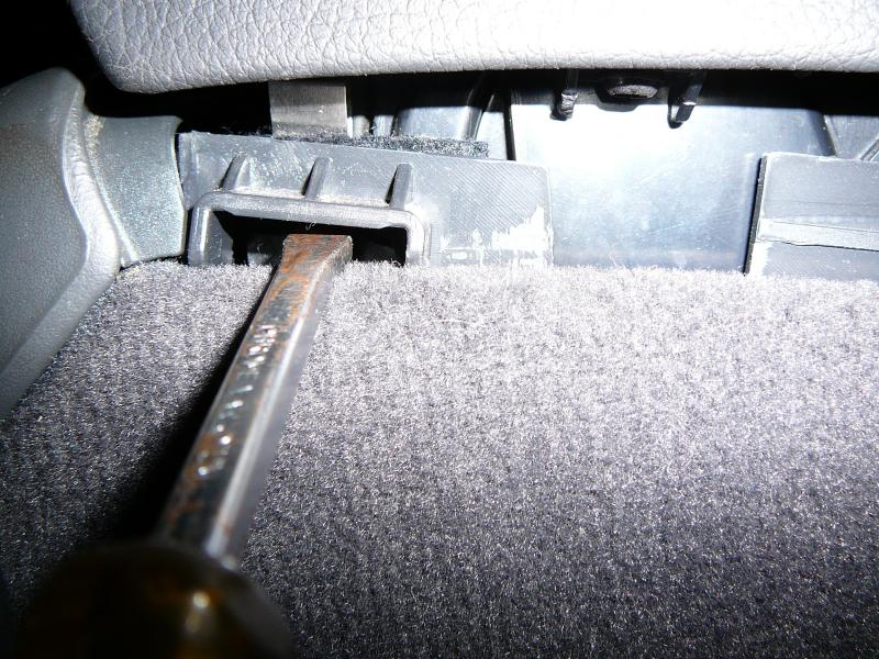

I found it difficult to release the rear of the console until I found the clips that needed to be pushed in. I've attached a couple photos of the clips and screwdriver used to depress them.
Attached Thumbnails W211 armrest-p1030756e55consoleclip.jpg   W211 armrest-p1030758e55consoleclip.jpg
