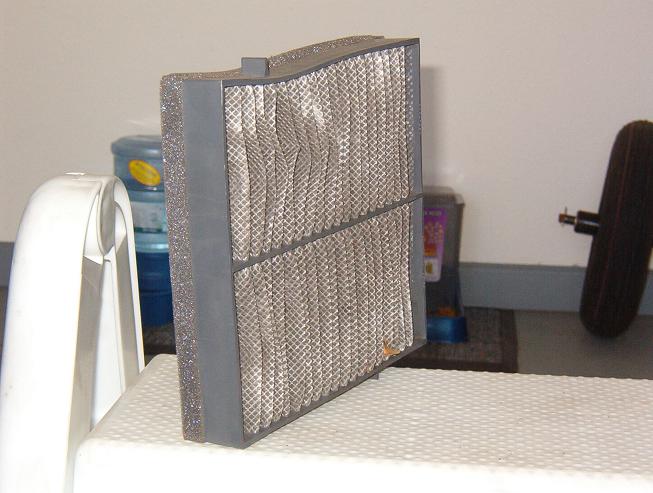

Changed the cabin air filter today on my 98 ML320, the amount of old leaves and debris that came out when the filter was removed was remarkable.
See attached photo, The old and new filters beside each other, (and this was after tapping out the loose stuff!)
There is a noticeable improvement in airfow now. My ML has approx 60,000mi It most likely has not been been changed in a very long time.

I turned around my filter and re-installed it.
Below is the picture of my old factory installed filter....the protruding stuck leaves in the filter will give you an idea of how it had been installed - clearly the other way around. So, did it come installed wrongly from factory???
Can such a mistake happen at the factory? I am not surprised, if it did happen, it went un-noticed in QA..
Attached Thumbnails Changed cabin air filter today, Big difference.-picture.jpg
