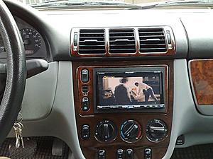

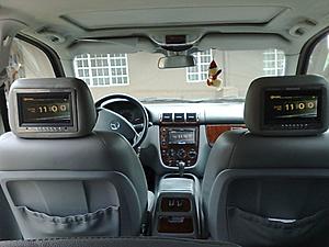

01 ML320
heres pics of my install. I opted for the pre installed 7 inch headrest monitors from ebay,a pioneer AVH p6800dvd headunit running the stock front and rear door speakers with a 12inch sub in the rear. The difference in sound quality is mind blowing compared to the standard mcs unit

07 GL450, 91 NSX, 12 Prius
Its not really a direct fit. I have a Avic-D3. That unit is smaller than the MCS. you need to make your own bracket. You also have to cut of the slider notch that helps the MCS slide in the opening. There isnt a kit to buy to mount a aftermarket unit to a W163. You then have to trim the include mounting plate to fit the MCS opening.
However you can buy a VW harness to connect the electrical. If you never installed a radios before, you should get a installer to do it.
