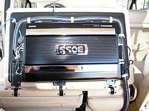

Now to the speakers. The BOSE amp is mounted on the firewall just to the left of and above the steering column, kind of above and behind the emergency brake pedal assembly. There is just one bolt holding it in place. The connector has all of the connections you will need for your amp outputs. You will find a good power here for your amp (RED) on pin 26 that is fed directly from fuse F-40 (30amp) and a good ground (BROWN) on pin 9. Now the speakers are as follows: left front - (BLUE)(GREEN) pins 13 and 21 with 13 being +, right front - (BLUE)(GREEN) pins 22 and 14 with 22 being +, left rear (PINK)(ORANGE) pins 23 and 15 with 23 +, right rear (PINK)(ORANGE) pins 25 and 17 with 25 being +. Now there are two more options for speakers, one is the rear speakers that are mounted close to the upper part of the back hatch (WHITE)(GREY) pins 24 and 16 with 16 being +. These speakers are connected together so in my opinion it would be best to tie into the rear speakers using say (PINK) pin 23 to the (GREY) pin 16 for the + and (ORANGE) pin 17 to (WHITE) pin 24. This way you will get all of the rear information to those 2 speakers and not just left or right. If you plan on using the factory subwoofer you will want to tap into (WHITE)(GREEN) on pins 11 and 19 with 19 being +. This connector is again located above and to the left of the steering column behind the emergency brake pedal assymly. I found through a little pulling here and there that there is a wire tie that is holding the cable in place roughly above the gas pedal, but if you cut this wire tie, one it will give you enough slack to get the cable down to where it’s a reasonable job to work on in stead of on your back under the dash dodging the brake pedal and other obstructions! And actually, there is enough slack that once I had my wiring done I managed to get the cable up behind the head unit in the dash.
So now we’ve got all of the wiring information to hook up a new system, my problem now was that I had ordered an amp that was, well let’s just say very large! 20” X 12”! When I got my 5 channel amp I was wondering where in the heck I was going to mount this mammoth! It was way to big to try and get back where the BOSE amp was, it was to big to fit under the seat where the BOSE subwoofer had been, to big to mount to the back of the 60% seat because of it’s contours and to big to mount on the side in the back. What I finally found was the covers mounted behind the back seats. The 60% one has a large enough surface for the monster amp to mount, all be it when installed, up side down since I decided I wanted to keep my cargo hauling capability so it had to go under the cover. The only issue is that with this ‘monster amp’ and the seats up, the cover does not rest on the cargo floor area as normal but on the amp itself. When the seats are down the cover rest in the normal position on the floor, so loaded cargo does not press on the amp but rather the way it was designed to, on the cover/floor.

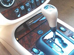

The last things I added were a USB plug on the center console in front of the shifter. This can be used to power a cell phone or USB stick for movies and music. The JVC unit allowed for one 4 port USB hub to be connected to its USB input, so the hub is installed behind the dash so that in the future I can add more ports if I find they might be useful. I also added the included microphone for the cell phone capabilities of the system. I wedged the microphone mounting bracket in behind the overhead console, and routed the wire along the headliner by pushing it in behind the headliner over to the A pillar and down behind the door seal until I got up under the dash.
At this point my back-up camera has not come in. I ordered one from Amazon that is listed as “Car Rear View Reverse Backup Waterproof CCD Camera for TOUAREG POLO PASSAT GOLF”. The dimensions are exactly the size of one of the license plate light lense covers, so this should fit right into where one of the license plate lights are. I will have to rout a wire from the camera, up the back hatch, down the body, and somehow find a way to the head unit! I’m thinking along the sides under the carpet by the doors. The camera will also require power, so switched power will also have to find it’s way to the camera. This should be an unobtrusive install that looks OEM, I hope anyway!
So now that your eyes are bleeding, that is how I replaced my Mercedes installed BOSE MCS no GPS, no Phone system in my 2003 ML350. As others have mentioned, I feel it was a wise decision to leave the BOSE speakers in place, they sound like completely different speakers with a good amp and good head unit driving them! Even before I hooked up the subwoofer the front door speakers put out more bass than the system did with the BOSE subwoofer hooked up! I must say that I am not a big BOSE fan, but I do respect them for making good products.
One note on the BOSE speakers, they are rated at 2 ohm impedance. This is important to know when buying an amp or if you are planning on the head unit powering your BOSE speakers. Most car speakers are rated at 4, 6 or 8 ohms as are most car amps and head units. A 2 ohm load on most amps is like a short and will cause your new amp or head unit to blow up or in any case not last very long! Make sure if you plan on keeping your BOSE speakers that you check the load handling capabilities of your new amp/head unit.

OK, I finally got my back up camera installed. I found one that had a wire-less system solving the running wires to the front of the car issue. Unfortunately I never found a camera that was listed as being for the W163’s. The camera was designed for Volkswagens. It was designed to put in place of one of the license plate lights. The outside dimensions were the same as the ML‘s, but then when I pulled the license plate light out, well lets just say that it isn’t exactly the same! I had to do some modifying! After a little cutting and manufacturing I finally got it in and it works great.
Being that my camera is wire-less I needed to find switched power in the rear hatch area to power the camera and transmitter. Actually, no matter what kind of camera you use, you will need power for the camera. Well, in my case that was easy! The AM/FM antenna amplifier is in the rear hatch and I powered it from the switched power since it no longer received it’s power from the now removed MCS, so I tapped into that. That will be on a (Red) wire on a connector by itself. You will recognize the antenna amplifier because it is the only thing that has an antenna type connector on it! This is a great option if you are installing a camera that you can access at anytime, this will be energized when ever the car is powered on. This will allow you to select the camera while you are driving if your head unit is so equipped. Handy to check your trailer while driving down the road.
Now, in the original article I mentioned that I had tied into the shifter for the reverse signal to switch the camera on. That didn’t actually work. Should have, but didn’t. On further review I noticed that there is actually a reverse signal sent to the MCS on the connector that is supposed to come from the CD changer PE 82.60-2000 on pin #3 (Grey). There you will find a good reverse signal.
Another find was that there is also a ‘speed’ signal sent to the MCS on PE 82.00-2700 pin #1 (Blue). This is the signal for the speed sensitive volume control. Now this may work on some, but this doesn’t seem to work to well on my JVC head unit. There was definitely a signal that was speed related on this wire, but it wasn’t something that the JVC was looking for. I connected it and the input threw the GPS way off! I drove about a quarter mile and the GPS should about 3 miles! Needless to say I disconnected that wire! I need to research to see if the GPS head unit is capable of learning the speed signal.
Lastly the GPS antenna connector that is in the factory wiring harness is the same as what came with my JVC head units GPS antenna. Even though my MCS was without GPS, the antenna and wiring was in place, so you should be able to use the factory installed antenna and wont have to find a place to install your new GPS antenna.

Keeping stock Bose amp, speakers and sub? Here are your speedbumps:
- audio signal from MCS to amp is via FO...unless you can find an aftermarket HU that sends audio via FO, might as well toss this idea away.
- Bose speakers and sub are 2-ohm impedance. Most HUs are 4-ohm. This means if you like loud volumes, you'd risk frying the speakers and/or HU. Although many ppl have kept their stock Bose and have enjoyed it (at moderate volumes).
- Unless your HU's internal amp is a 5-channel (most likely not), you'd need either a separate amp + sub or a powered sub.
- The HU's internal amp may/may not be adequate to your liking, therefore, you may/may not consider having an aftermarket amp.
- The additional features that you'd like (BT, camera, etc...) that obviously depends on the brand/model of the HU of your choice.

Quip11,
The copper speaker wires that goes straight to the speakers are from the Bose amp, which is up above the driver's brake pedal, towards the door side and behind the white insulation. I bought a Rockford Fosgate mini amp so that it can fit in the spot where the Bose amp used to live. I installed the low-profile powered sub underneath the passenger seat.
If you planned on a 5-channel amp, then you'd be looking at a different placement (amp too big to go where the Bose amp lived). Then, run your audio signal to 5-channel amp, then back to where the Bose amp lived, so you can connect to the speaker wires (in a big plug that plugs into the Bose amp).
I have attached a link to the same Rockford Fosgate mini amp as mine and it handles both 4ohm and 2ohm (my mini amp can only do 4ohm). This way, when you are ready to or if you'd like to upgrade the speakers then you wouldn't have to worry about having to get a different amp.

I want to thank you for your post and your help with this project. I wouldn't have the courage for it if you weren't around.
The main challenge for me was the Bose amp. Once I realized that it had to go then everything becomes straight forward.
I ended up getting the Dual DV695MB for head unit, 40-VW12 for antenna adapter, Metra 70-1786 for wiring harness. The Metra was un-necessary and I didn't have to get a Scosche dash kit as the Dual comes with one. I also didn't get an amplifier as the sounds seem to be fine for me without one.

DrDoelooks good!
It wasn't till is found an obscure Russian YouTube video about cutting off the guide tabs that I wouldn't have done the change either. In all my searches I could only find completed installs but nothing explaining some of the issues.
I wanted a little more power and a larger subwoofer. My under seat sub was starting to come apart due to age. Unfortunately I didn't pay attention to the size of the amp I ordered. I had planned on installing it in the original factory location. But from the pictures you can tell there was no way that was going to happen! I must say that I was impressed with the BOSE speakers once I had an amp that could actually power them and the 10"" subwoofer.
