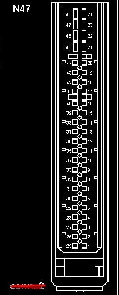

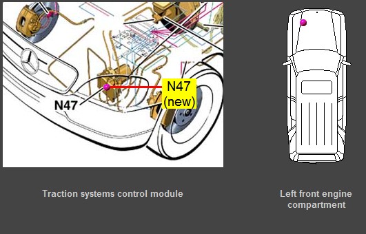

Having a CAN communication problem does not automatically mean the a control module is at fault.
As of model year 2003, M/B switched the location of the ESP/Traction Control Module from the fuse box to the face of the ETS Hydraulic Unit with one large 48 wire connector.
Because of its outside location, there have been many instances of corrosion at the 48 pin connector and or broken wires in the harness.
Remove the left front wheel and then the wheel liner. Remove the connector and strip the harness covering as far as you can and inspect all wires, especially WHITE wire #11 and GREEN wire #15, which are the two CAN communication wires.
If you are not handy, or have the ability , you will have to take it to a repair shop to have it checked before even thinking of replacing the module.

I will take it to a repair shop to have it checked out. If the CAN communication wires are o.k and it happens that the control module should be changed. Where is this module located or what autopart contains this module (would that be the ABS Pump)? A picture would be so helpful. Thanks
Yes, I already supplied you with an illustration photo in my previous post.
But if a module is needed you can buy one without the Hydraulic Unit.

This is the problem. I am not based in the US so it may not be possible to by the module separately except if it is detachable from the device itself. Used parts dealers here wont want to do that. They will insist the whole unit that has the module be purchased. The last time I have an issue with the ESP, i think a module was the issue and I ended up buying the whole ABS pump. Please what is the hydraulic unit called and where is it located?

First of all you haven't even determined if you have any broke wires. This is the main thing and if you do have a broken wire/s it is unnecessary to buy the module.
Why do you keep asking me where it is located when I have posted a photo twice. What more do you want from me?
