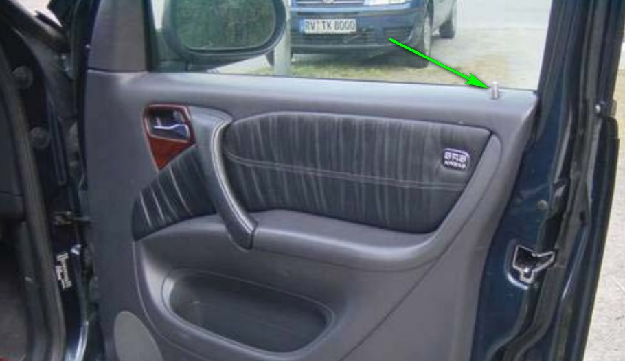

What I meant was to disconnect the battery and then try to pull up the door button.

That was the first thing I did, but nothing.
I took a pair of pliers and while pulling on the tab and the inside handle I was able to get it open.
While outside if the door, I tried to move the lock/unlock tab and it kept going back to lock position.
I kept the older unit and swapped the entire motor housing and it is working now.
Thank you for your help.
