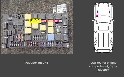

The first thing to do is to check fuse #45 to see if it is blown.
If not, remove the two covers on top of the fuse box and access conn. X22. This conn. will be on top of all the wires.
With the eng. cold, find wire #8 Red/Wht. Do not separate the conn. Pierce wires on both sides of the conn. with back probers.
Have someone start the eng. while you test both wires for 12v. Post results.

WOW! What a surprise. I'm not quite sure what I said that pi$$ed you off but, after my post directed to you I took your advise and chased down the two red/wht wires and I do get a 12V reading upon starting from a cold start.
