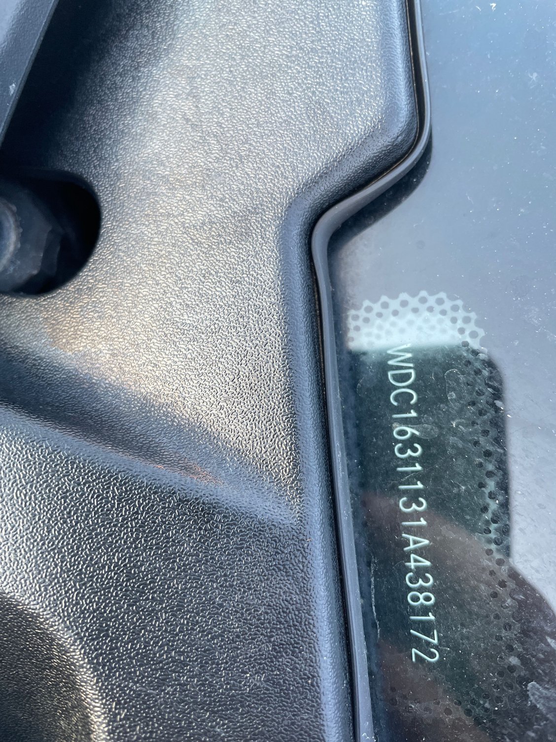

Post your vin#.
Old May 8, 2021 | 01:28 PM
Lovász Viktor's Avatar
Joined: Apr 2021
Posts: 12
ML 270 CDI 2004
Originally Posted by Maj. Dundee
Post your vin#.
Old May 8, 2021 | 02:38 PM
