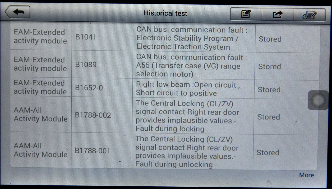

Can anyone help me out on these errors?
Do I clear them all, then re-do the whole thing and see what comes up, or will it be the same as these show?
I hvae an autel MP808, but also found out it cannot relearn mercedes throttle positions, bummer.

Okay, now all errors are almost gone.
I unplugged every connector i touched in the removal of the rocker covers and replacing the alternator, battery, and the washer fluid bottle.
Also the error showing the open circuit on the headlights, which was simply I forgot to put the hid bulb back in when I rebuilt the headlights with new seals and polished the plastic lens, so the units look 100% brand new again.
Only other problem I have is it will not rev past 5k rpm on the throttle.

I have just found the answer on my AUTEL system.
It showed two possible fixes for the fault.
First one is to relearn the module, and along side it also tells you it may need reprogrammed if not able to relearn, which of course my AUTEL system cannot do for this model of mercedes.
I will find and post the actual screen I saw this on while hooked up with the AUTEL.
re-programming throttle postion sensors via a computer hook-up is all over youtube, and you see how they do it live.
I cannot do this, as my AUTEL system does not have this module installed, so a dealer will have to do this for me, or someone who can communicate with the sensor via there system.
So folks the mercedes garage and technician were NOT TALKING CRAP to me about my problem.
They knew instantly that it needs reprogramming, not relearning.
I am going to take the Merc. to a local tyre garage i know, who do MOT's and next door to them have a high-end tuning garage, where racing cars and rally cars are always being rebuilt or upgraded.
This is in a little tiny village called Crosshands, in Wales.
They will be able to hook into my merc and reprogram the sensor as this would need doing if they got the merc for an MOT , changed the throttle pedal and cable, and found the throttle stopped working properly.
I am going out to plug in my system to show you all the sensor fault and fix, showing it has to be re-programmed if not able to be relearned.
I am also surprised no-one in this forum knows anything about this wht-so-ever?
as in throttle position sensors can be reprogrammed to work.

to all who followed this thread, my loss of throttle after replacing the throttle cable and pedal coincided with the failure of the ETC/EGS module.
If you all look at the read-out above from the diagnostic scanner it actually shows and states the problem of why i have lost throttle and almost stuck in limp mode.
It shows it had a fault at an earlier time, and shows the earlier fault and current one right now.
P2001 - N15/3 ETC-Eletronic Transmission Control ETC/EGS Module Faulty.
All I have to do now is find it, as it is a right hand drive car, so not beside the throttle pedal assembly, as this houses a fuse-box on top of the engine main harness and fuse-box. (It might be hidden in there)
So maybe under the passenger side footwell, above the feet, as the left foot panel houses the bonnet catch handle and mechanism, so not in there.
So thread is finished and over and I have my problem and will get it fixed.
