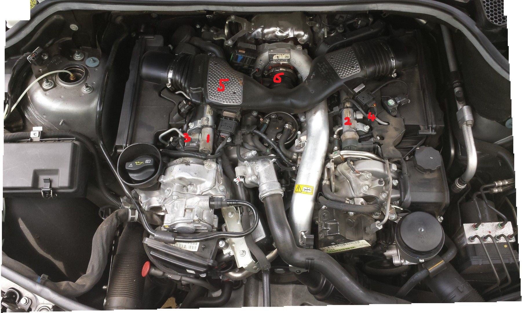

The glow plug light is staying on for approx 45 seconds from cold start.
As I understand it the plugs or the controller are at fault.
I need to get at the glow plugs to test the resistance but need to locate them and access the top of them to test.
I think you are right they are buried. Any ideas what the items are in the photo below?
What are items 1 & 2?
How are items 1 to 6 removed?
Is there any liquid in items 3 & 4?
Old Feb 19, 2015 | 08:03 AM
N_Jay's Avatar
Joined: Aug 2010
Posts: 12,516
Likes: 628
From: Charlotte NC area
2019 WS222 S450 4-Matic / 2007 W211 E350 4Matic (Sold) / 2008 X164 GL320 CDI
Attachment 304236
Do you have a check engine light?
Does it start OK?
The controller should report any errors unless it is dead, and in that case the ECU should report the error.
How cold is it? 45 seconds seems long, but time it because people guess time poorly.
Old Feb 19, 2015 | 04:42 PM

Hi
I have the yellow curly light on instrument dash.
Starts perfectly fine and yes it does stay on for 45 seconds only when started after car left overnight or for long periods of being stationary 8hrs.
Light does not stay on when starting for up after engine has been running only on first or long period of standing.
Australia is warm 20 to 30+ deg at present.
How do I check errors I do not have a star diagnostic unit?
