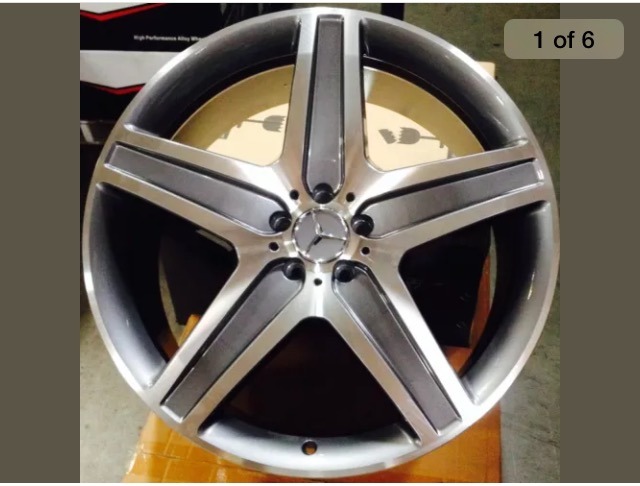

I'm looking at...er...just ordered the below 22" wheels for my 2009 ML350 4matic. I don't know much about offsets and am concerned about them sticking out past the fenders too much- does anyone know if they will? Thanks guys!!! 22x10 offset 50+

You'll be fine with that width & offset.

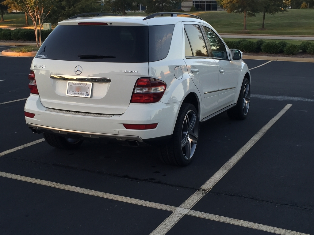

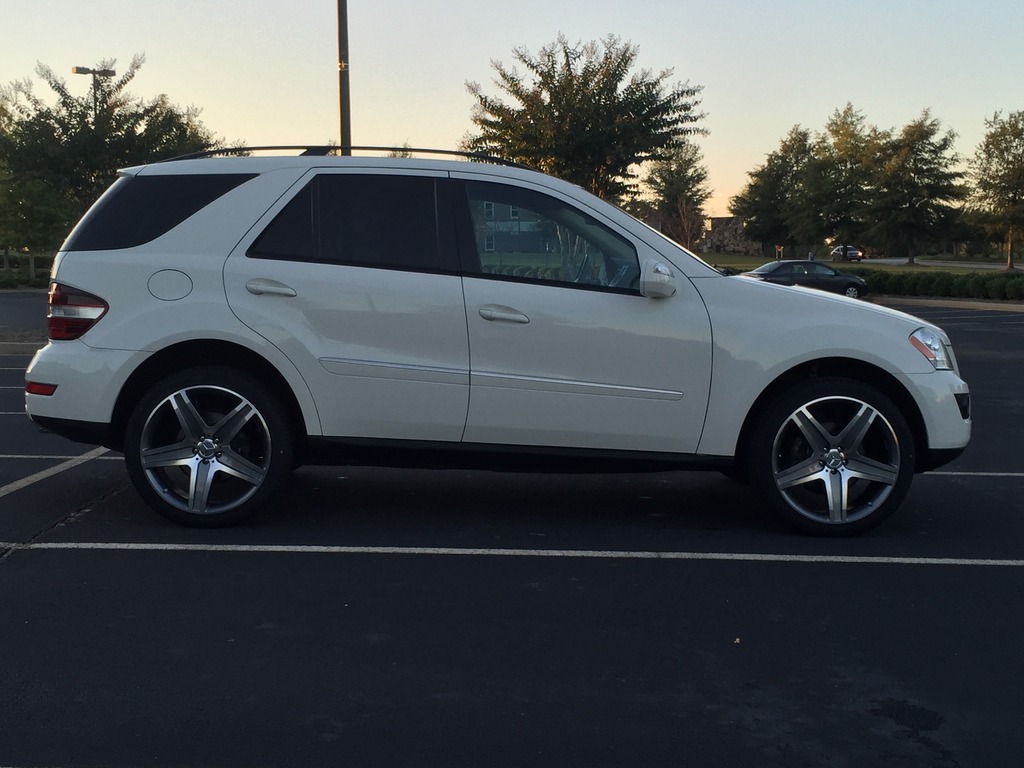

Hey guys, this is why I love that tire shop- way ahead of schedule they got my lug bolts ordered and delivered, balanced my wheels/tires (I told them they were already balanced but they double checked it just to be safe, and ended up making some corrections), repaired the cross threaded hole in my hub, took some photos of a few blemishes that came on the wheels, and got them installed.
Let me know if you guys think I should lower!
