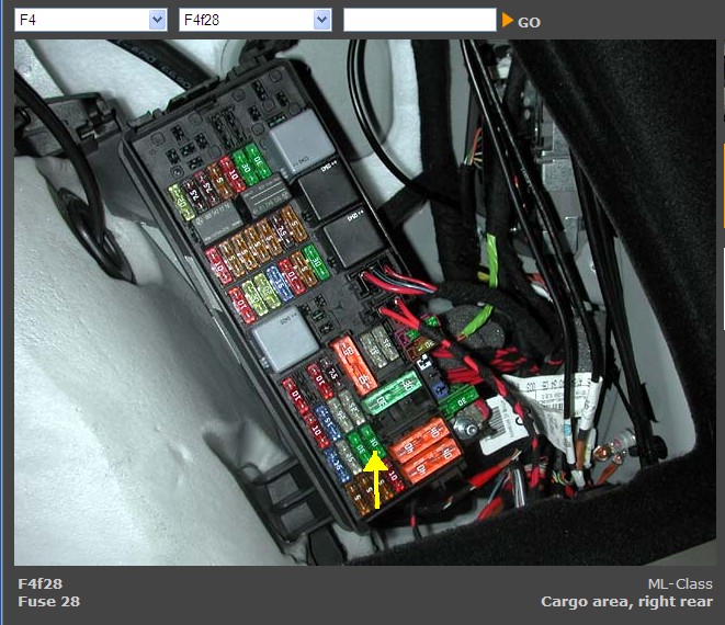

I have no other thoughts on this, I was trying to suggest that buying two batteries would be a waste of money.
If it's the driver's seat remove fuse #28 in the Load Comp. Fuse Box and then reinsert. If it's the passenger seat, it's the green fuse next to it.
Thoughtful tip -- thanks!

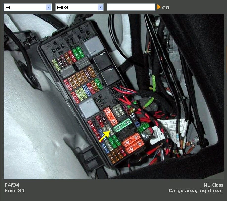

I just bought a 2009 ML350 4matic, without memory seats. I have the same problem...as soon as I open the door, the lumbar support slightly inflates, requiring pressing the release button (rearward) on every drive. Not a big deal, and maybe faulty module? I tried the remove and replace fuse procedure, with no change. Further thoughts anyone? Thanks all. Full VIN is 4JGBB86E19A466768.

With the key out of the ign., remove fuse #28 and fuse #34 wait one min. and reinsert.
