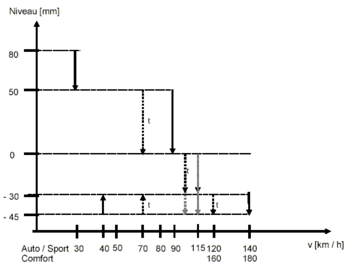

Hi,
Does anybody know where I can find the information about vehicle height in different Airmatic settings (sport, comfort, raised level).
For example road surface to fender measurements. The car has airmatic + ADS.
If any owner is prepared to check this distances and share here would be great
Thanks!

I could not find anything in WIS, but you owner's manual shows the below. The 42 footnote is for air suspension.

I am still trying to get the information about car height in different airmatic settings (sport, comfort, raised level). The best measurement would be from ground to fender (front and rear) but it is impossible to get these info. I asked MB service and their answer was: We don't know. ?!?
Will try to find someone with the same car and ask him if I can measure by myself so that I can compare with my car....Would be great if someone from this forum can do this.
Old Jun 11, 2018 | 02:10 AM
p0stscr1pt's Avatar
Joined: Jun 2018
W164
Without "Offroad Pro Technikpaket"
With Offroad Pro Technikpaket
