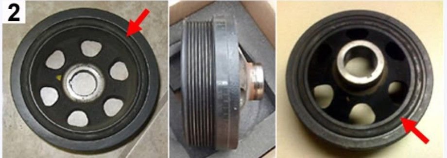

Did you see him moving the flywheel?
When the car is idling, have you looked at the harmonic balancer to see if it is wobbling?

Thanks for your reply.
I did look at all the pulleys and saw no wobbling.
Then there is no play in the Crankshaft as it would immediately show a wobble at the pulley.
