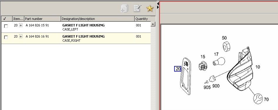

Have you replaced both Tail Lamp seals? They must be attached to the body opening, not to the lamps.

���� The 20 liter of water came from inside the boot so I did not replace any seals.

Buy those two seals to prevent further water entry and then deal with the rear SAM.

Don't forget about replacing the tail lamp seals.

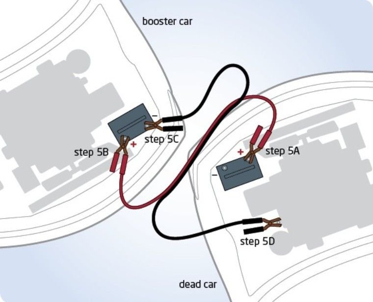

When you are jumping a M/B veh. the key must not be in the ign. in any position. The DAS control Module has now been scrambled. Codes will be stored in the DAS & EIS and ECM Modules.

Hi, a couple of things. As noted in my original post the car has been scanned using an iCarsoft scanner with no faults recorded. How would you jump start a car (any car) without the key in the ignition?

The POSITIVE jumper cable must be attached FIRST, then the NEGATIVE cable always LAST.
