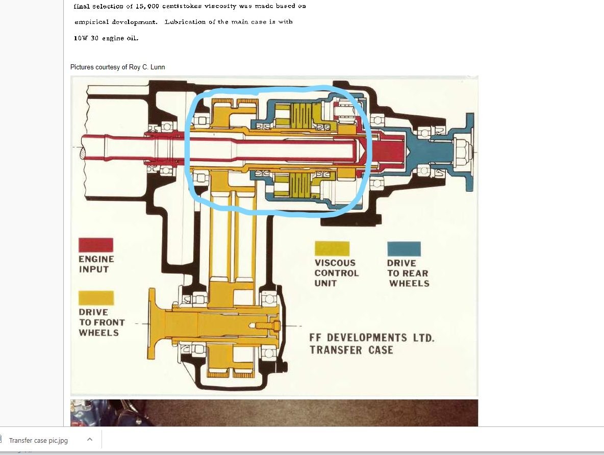

We have. NO codes. I highlighted the problem area in my transfer case .There is no power flow from the Main shaft to the Gear that drives the Chain most likely due to the clutch failure/wear in the center differential . I want to see if it can find a repair kit that’s all I’m asking

The TC is simple...it has an input from the engine. Then, the input shaft goes through to the rear, and the sprocket on the shaft provides torque to the front via the chain. If the rears move from the power of the engine and the fronts don't, then something internally has broken inside the TC...time to open it up and investigate.
Keep in mind that a rebuilt TC from MB is around $6k. I was able to find other rebuilt ones not through MB for about $3k. Then I found a used one on ebay with a 1 year warranty for around $800. Then I decided to R&R the chain for $90. A worn chain is the most common failure, but if yous is not moving at all, you may have other isuues.
