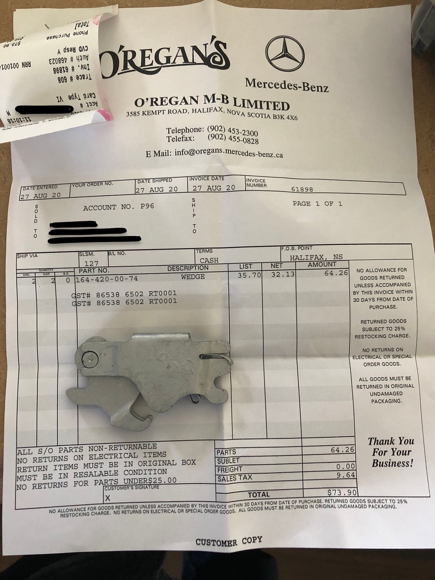

I just ordered them from the dealer. They call them the shackle wedge. $35 each.

Hi all,
For those who may have been following this, the correct part number is 164-420-00-74
This is the same part for models W251, W164 and X164
This is known as an expansion lock, wedge, expander, etc
