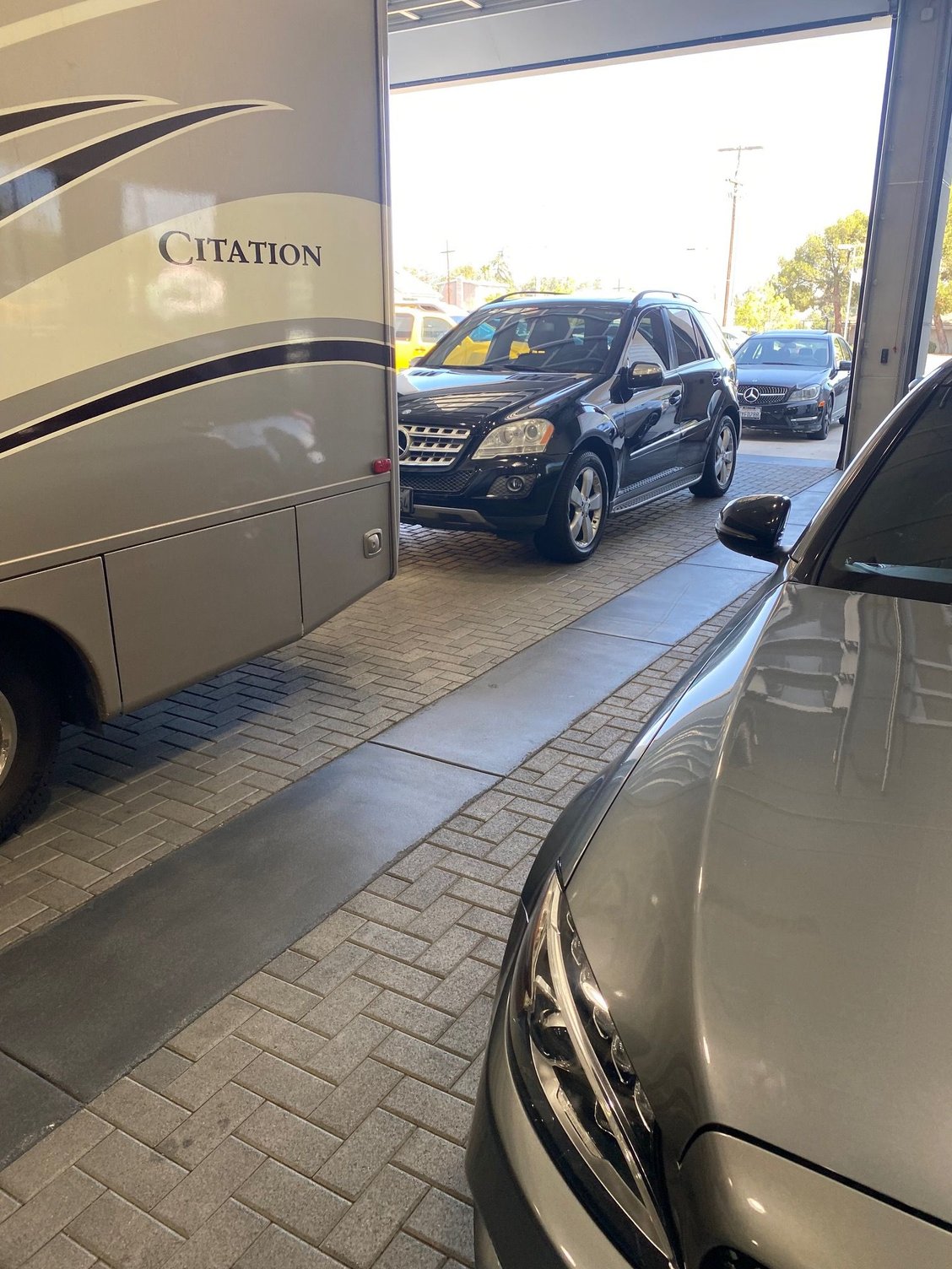

Same here. Drove it in, they had it half a day, inspected it, noted it was fine (SoCal car) and sent me on my way with a smile and a car wash that it didn't really need.
There were over 20 ML/GL SUVs there when I showed up. Can't say enough about Jussef and the team at Mercedes El Cajon. Total pros and incredible to deal with.
