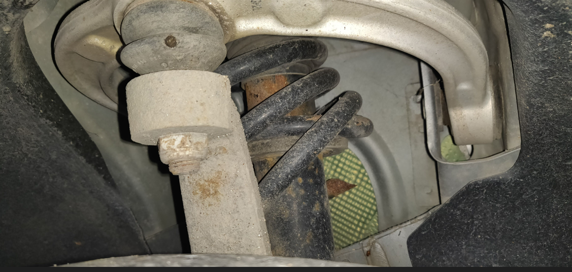

Hi folks, new w164 Bluetec owner for a few months now. It has 175,000 KM (108,000 miles). Been hearing a suspension noise that sounds like metal on metal. It would sometimes go away. Its back now and worse. Had a look today and thought I would share pictures. The coil springs do not look the same on the front side. I have attached pics below for your reference. Can anyone tell me what is wrong and how it became that way?
Thanks in advance folks!
Front passenger side.

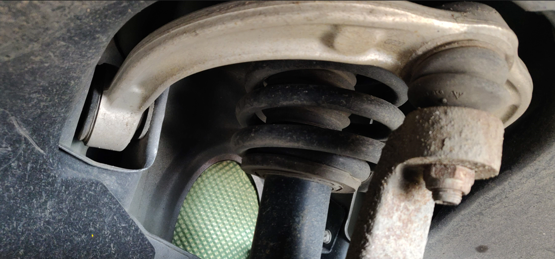

Front driver side.

Your spring is broken. Seems to be a common issue around here.

I wonder how urgent this repair is? Seems like the broken part is away from the tire and other components. Wondering if anyone can chime in. Thanks

You are asking how urgent it is to fix a major suspension component? Not at all if you are not driving!
Get it taken care of ASAP!!!!!!

Seconded ...you should not drive a car with a broken spring.
