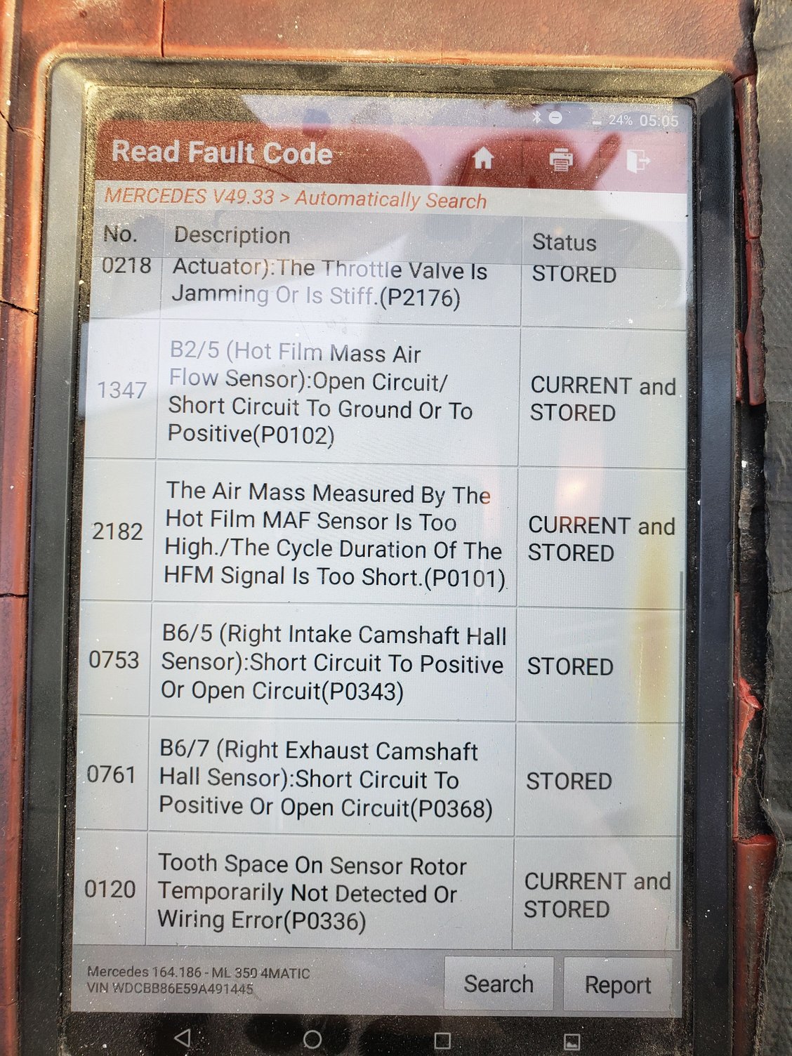

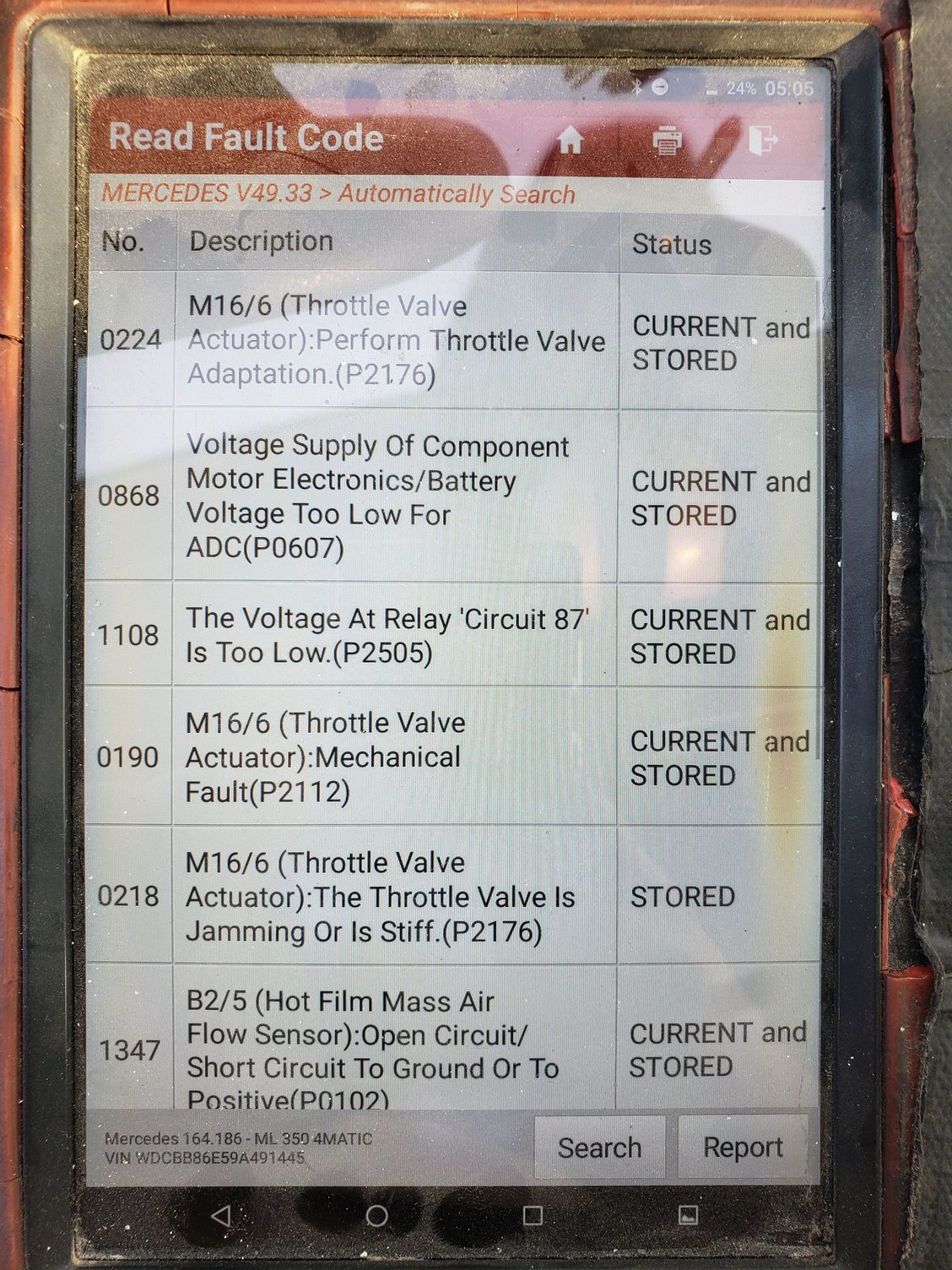

I kinda suspect the ECU because several days ago I scanned the ECU for DTCs and several codes showed up that I never saw before, such as a bad MAF sensor and few others, tried clearing them and only two left and those two never showed up before. And the second reason is that unfortunately bad ECUs is kinda common issue on the 272 and 273 platforms because of its location.

Just scanned the ECU and got those DTCs, never seen them before

Ok guys, nevermind, just got it fixed.
Indeed it was the ECU, got a used one and got it programmed, car fired right up.
Hope this helps someone.
