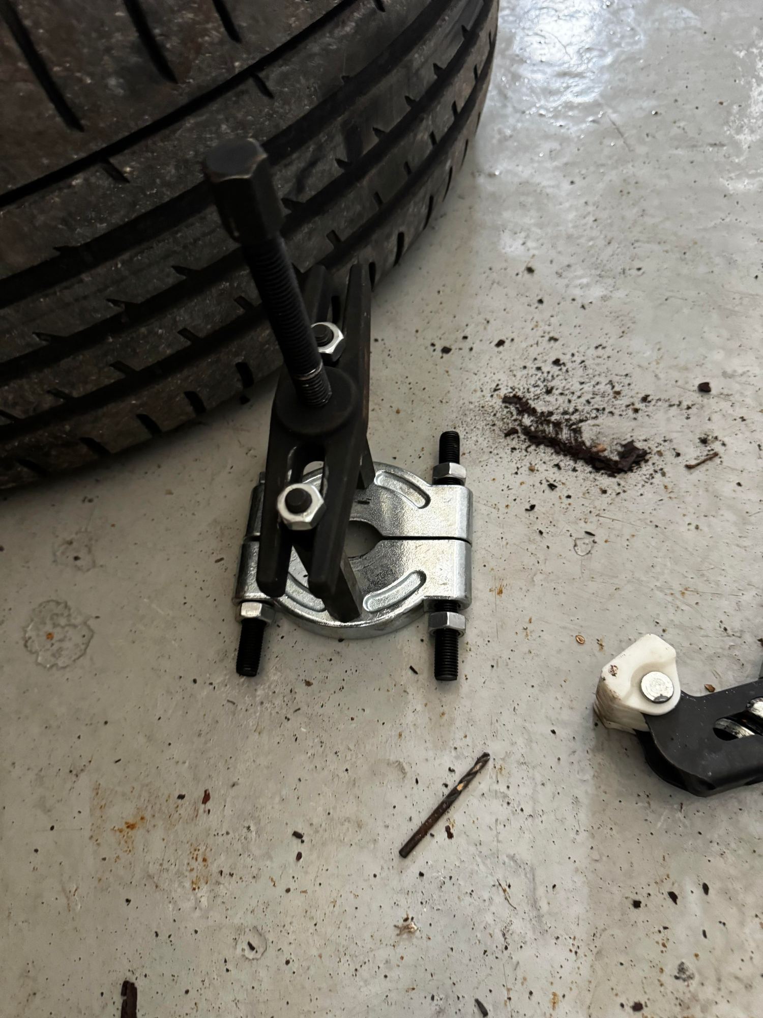

oh man what a pain to remove cv axles,tried hammering like these youtubers said but that didnt do anything so i removed brake caliper (21mm socket),removed rotor and used this tool to separate it,i thought the tool is going to brake but it survived,also upper control arm didnt wanna separate so i had to use bearing puller tool,

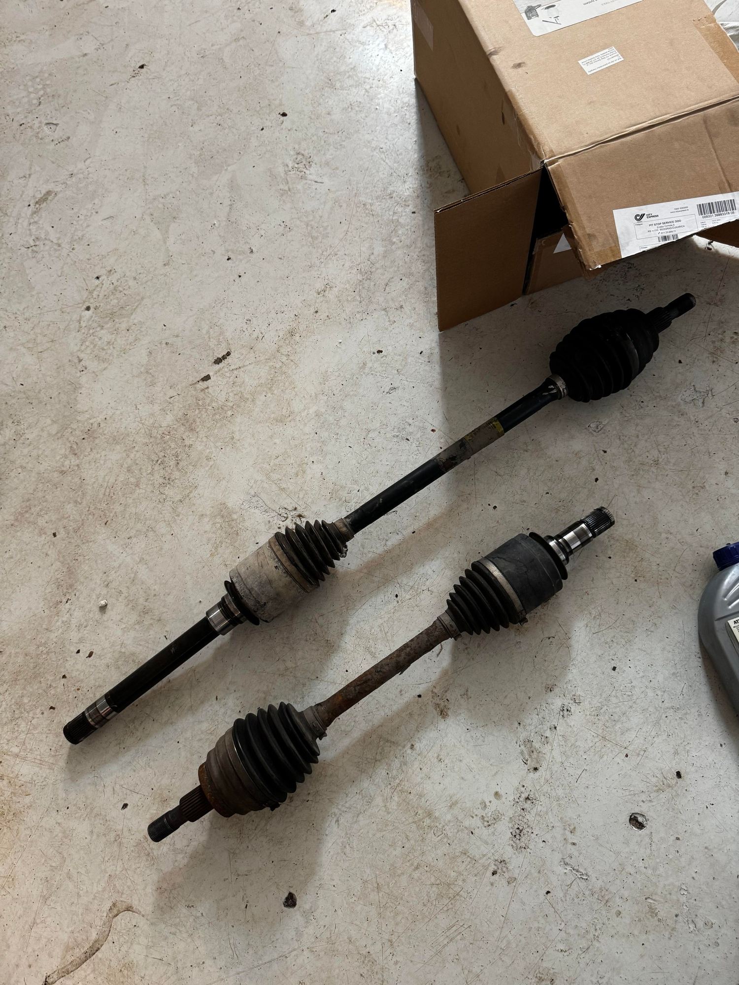

had a little hard time putting cv axles back in but found out that little grease around retaining clip makes it easier,
installed new magneti marelli cv axles,one came without retaining c clip but i transfered it from the old one,do not bend it,

drives a lot smoother with new cv axles,everything is good,next is transfer case chain that is making noise under heavy load,and driveshaft center bearing,lots of physical power is needed so better be in shape

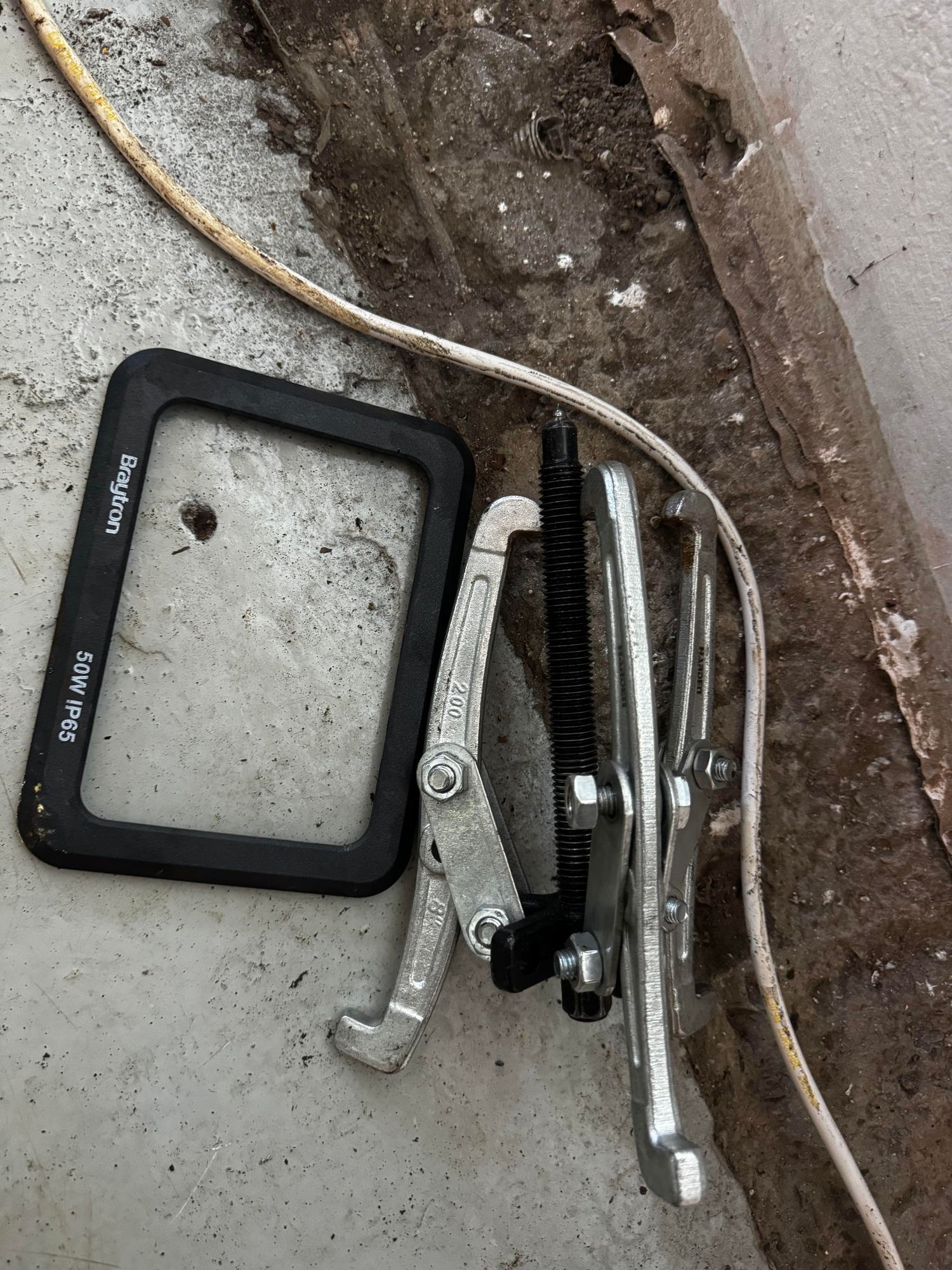

3 jaw puller,preferably heavy duty one,(do not hook it up to a brake disc outer edge)get one that bolts to wheel bolt holes ideally,mercedes oem tool for this is W210589034300 and it cost 500ish
