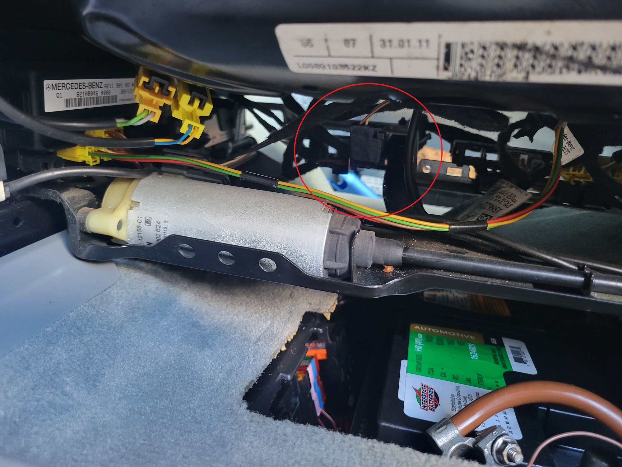

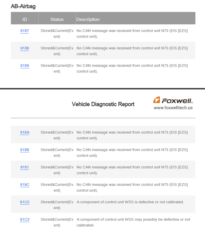

Hi all, I am trying to figure out the SRS light on the gauge cluster. The following codes appeared after a diagnostic scan. Taking a look at the passenger seat I noticed the following was unplugged. Does anyone know where that connects to and if it could be the culprit of the SRS light? Thanks in advanced

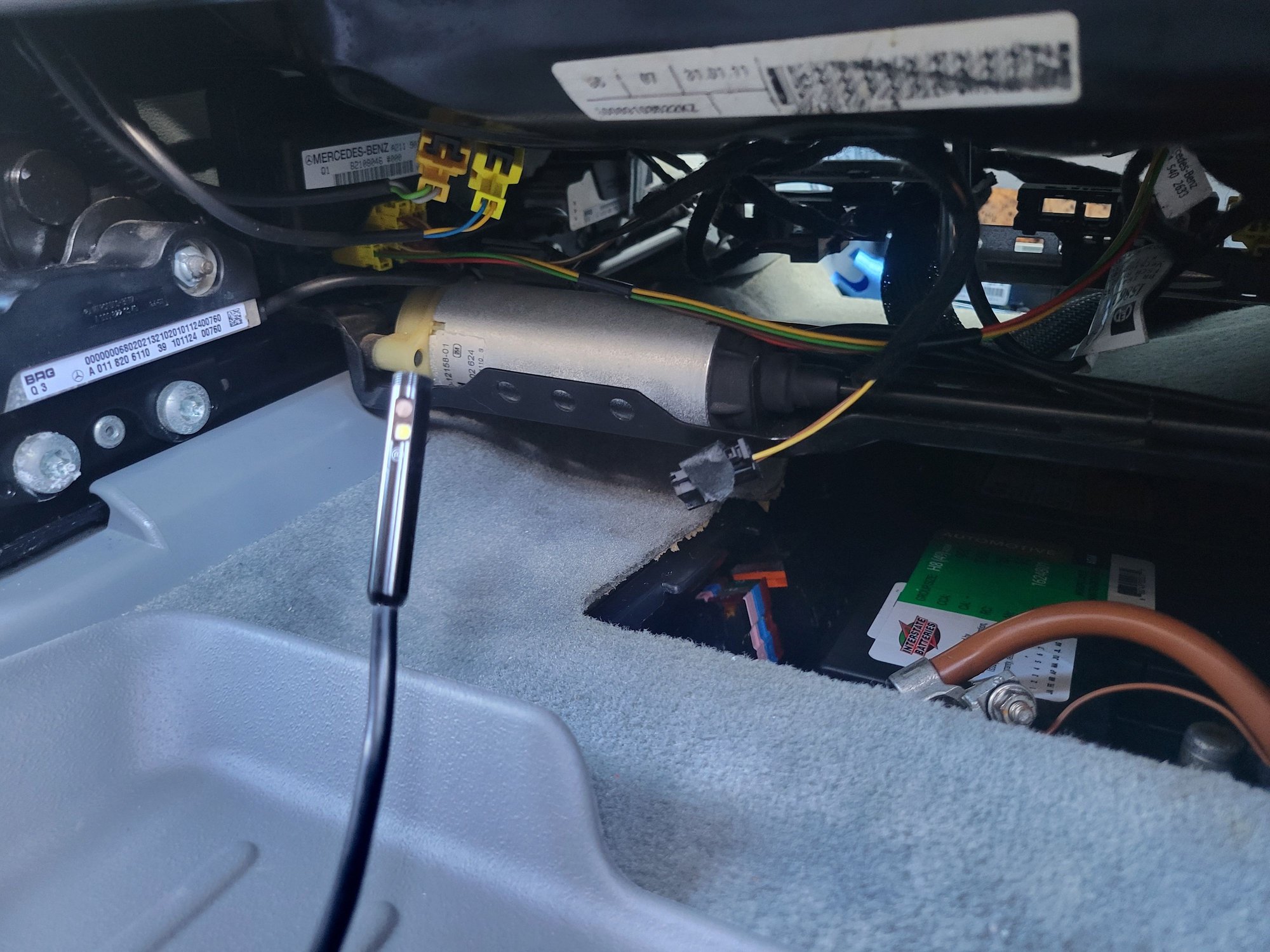

Might be a long shot, but does anyone have a picture of the connections under their passenger seat?

Don't have a photo but isn't the N73 module the Electronic Ignition Switch? Based on the codes you have which appear to be all related to that - have you had any problems starting the car? All Benz's of this era have the EIS fault which is easily fixed. That might be your problem.

An unplugged connector will indeed create an SRS light.
plugging it in will not turn off the warning light.
this can only be done with a fairly sophisticated code reader.
