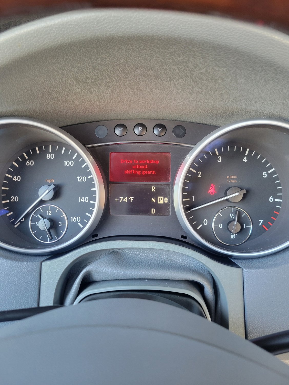

Hi all, started the car and while the door was open I turned it off. Now I am getting the following messages...
"Door Open Vehicle Not In Park"
"Drive To Workshop Without Shifting Gears"
I have a new battery and new auxiliary battery (OEM).
Fault code P179D85 - The redundancy system for DIRECT SELECT was activated. There is a signal above the permissible limit value
The car starts fine but now I cannot shift it into gears, i.e., drive, reverse, or neutral.
Any suggestions?
2011 ML350
Thanks in advance
