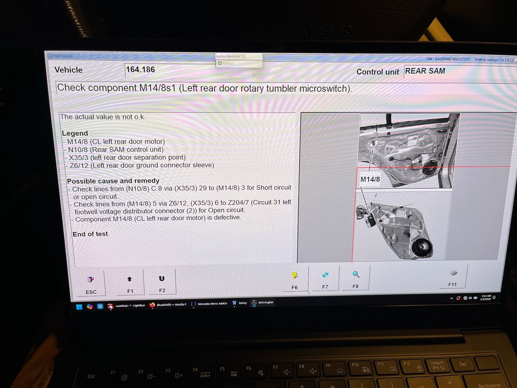

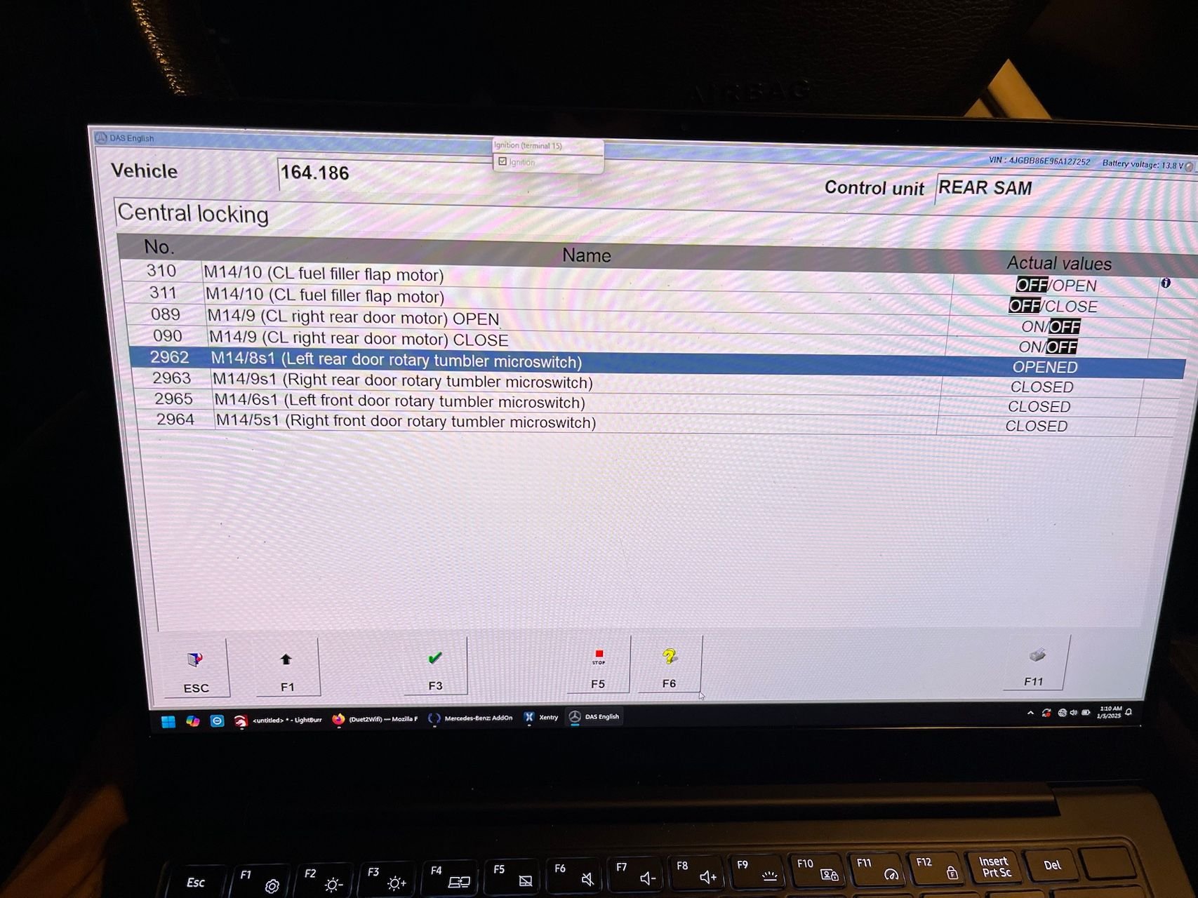

hey all trying to fix ML350 '06 W164 - rear left door status is open regardless if door is actually closed or open. (as result foot well lights is on and red message pops up on IC when driving)
I tested micro switch in lock mechanism it works ok, tested cable up to door connector and its ok (lock works properly by the way)
based on michroswitch seams that door status opne is when switch is is High so that means to me thta wire is short to ground some where or rear sam going crazy. there no codes on R-SAM
xentry shays

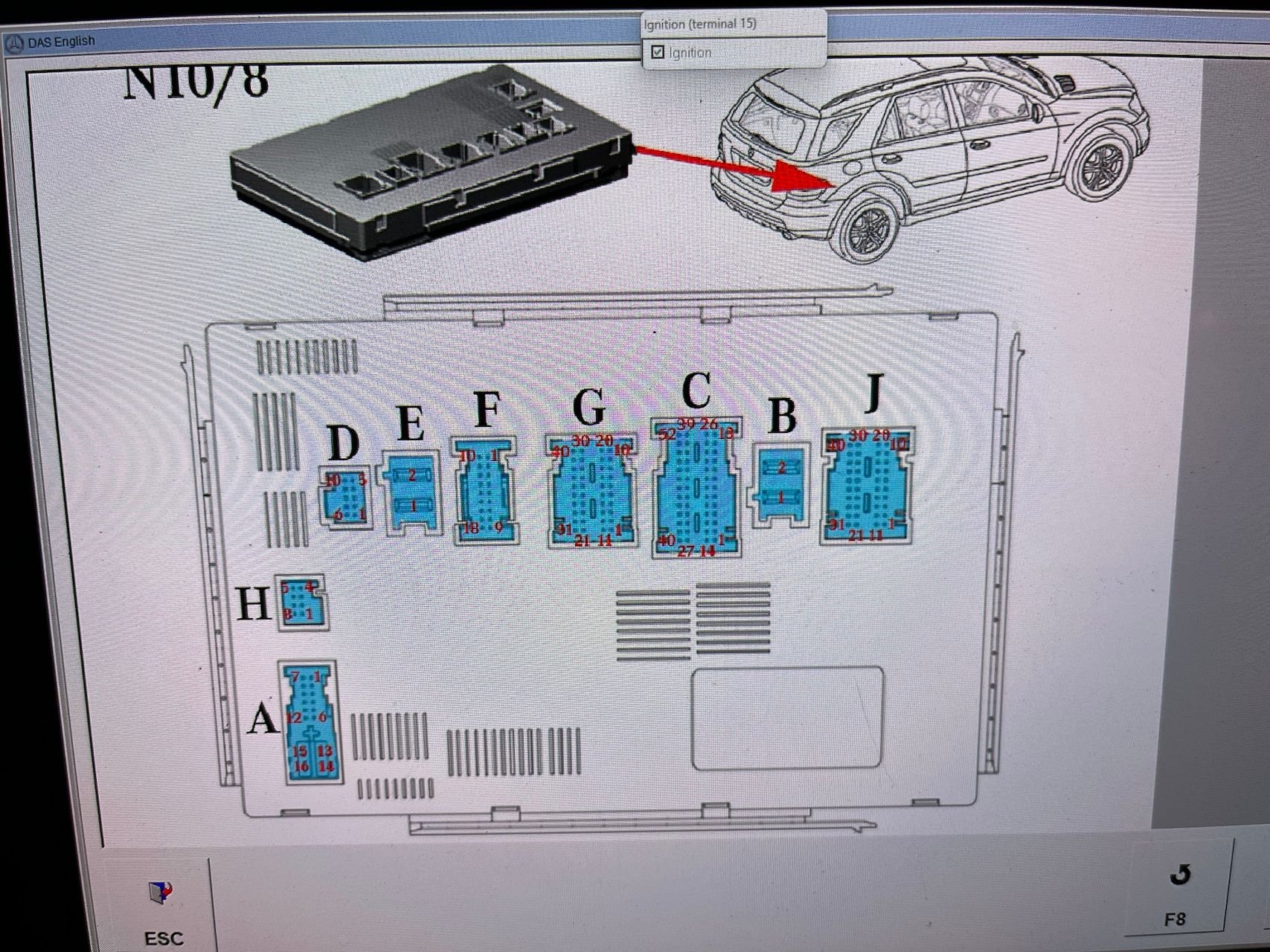

Does any one know what is X35/3 components is what xentry reffers too? also what position does door switch terminates on R-SAM connectors and what connector would that be?
my idea to disconnect connector and see what happens if i see same opens status then is R-SAM is problem goes away then its wire some where just need to trace it and need to figure out what wire on connector. on door its Red with Black Stripe
so maybe some one know what X35/3 is and what connector it goes to on R-SAM
or any other recommendations tnx

X35/3 is the connector from the door to the main harness
