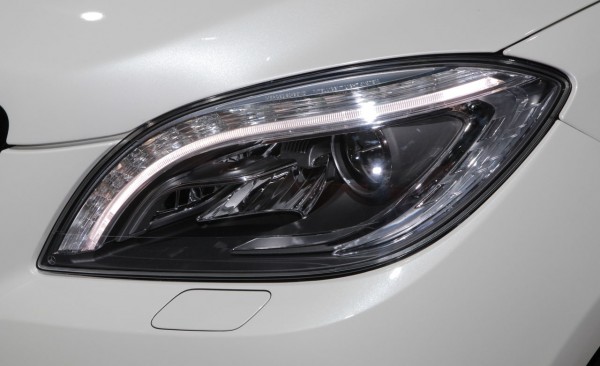

No comparison in my opinion...I mean look at this...

Mine are white.

My day time running lights are white...
The photo above is not of my vehicle.

[QUOTE=Dr.GL450;4972976]No comparison in my opinion...I mean look at this...
I agree I really wanted those lights
Only problem is MB won't sell them to us! A 7 month wait is ridiculous.

[QUOTE=jtorrebl;4973814]
The US version will not look like this! The corner lights will be Yellow...
Are you sure they won't just use yellow bulbs or LEDs with the clear, like my M3 does?
