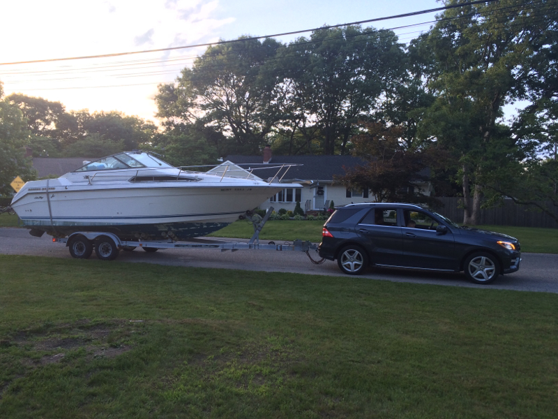

Recently started towing my 25' Sea Ray(7000lbs+ with trailer). Has anybody experienced false error codes in the display for their trailer? They say to check the left/right trailer lights but everything is functioning perfectly. The right turn signal indicator also flashes at a faster rate as though a light is out, again, every indicator on the truck and trailer are operating properly... Strange. I use the adapter for the 4 pin connection to the trailer. I've towed this boat with an 04' grand Cherokee 4.7 V8, 08' QX56, 09' grand Cherokee 5.7 V8 and it's shocking how easily the 550 accelerates with all this weight behind it.
