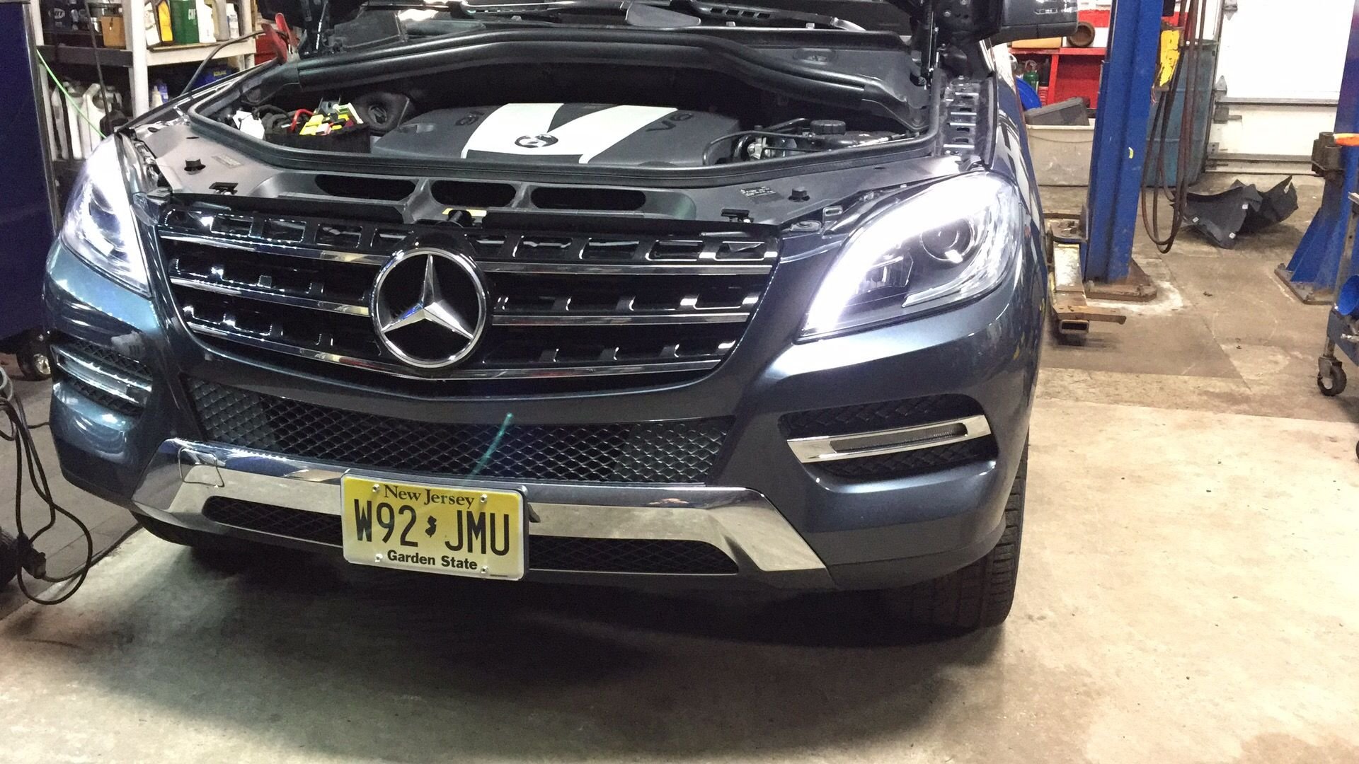

Smile Upgrading My Halogen Headlights to ILS headlights. W166
this is my 2012 ML350 Bluetec, came with halogen headlights (garbage) found a company in china that sales this headlights with modules, they reprogram the SAM remotely using the MB start diagnostics scanner and team viewer.
Headlights follow the steering wheel, also the turn signal or curve assist works. if you like to have info about this headlights let me know.
I also have videos of the headlights working.... don't know how to upload them.
ILS installed and working with CAN communication. Curve assist
