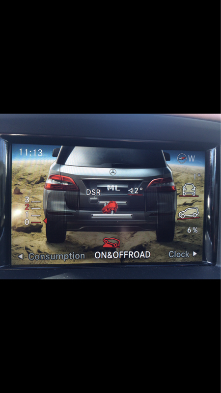

I have a 13' ML550 with the on/off road package. It comes with a low speed transfer case(2.93:1 crawl ratio,) 6 driving modes(sport, auto, snow, trailer, off road 1 and off road 2) that each adjust the throttle sensitivity, suspension height and compliance as well as the steering effort. You can also control the height of the vehicle independently. There is a 4" height difference between the lowest mode(sport) and the highest setting that is approximately 11.5" of ground clearance. The sport mode all but eliminates body roll.
Attached Thumbnails Active Curve System-image-1844594813.jpg   Active Curve System-image-360963601.jpg
