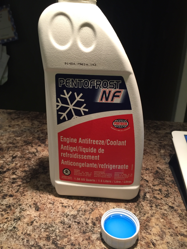

13' 550 4.6TT This is what I was given. The warning triggered once during very cold weather last winter. Maybe 2 ounces and it's never gone off again.

Ok. There is a very common leak on those from the plastic y pipe fitting where the left turbo coolant return line enters it around the top of the engine and between the drivers side of engine and the reservoir. Make sure you don't see some evidence of coolant leaking there.

Thanks for the info. Apparently that's one of the few issues my truck HASN'T had in my few years of ownership. Luckily I only had to top it off with that small amount once.
