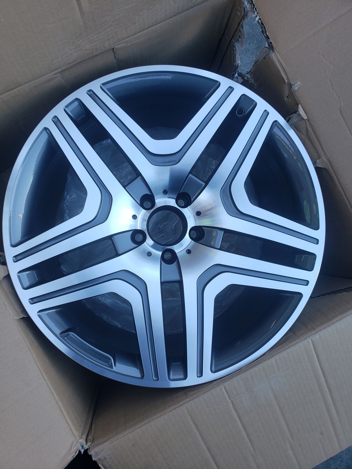

I have AMG replicas for sale 20x10 of set 45
I have the center caps as well.

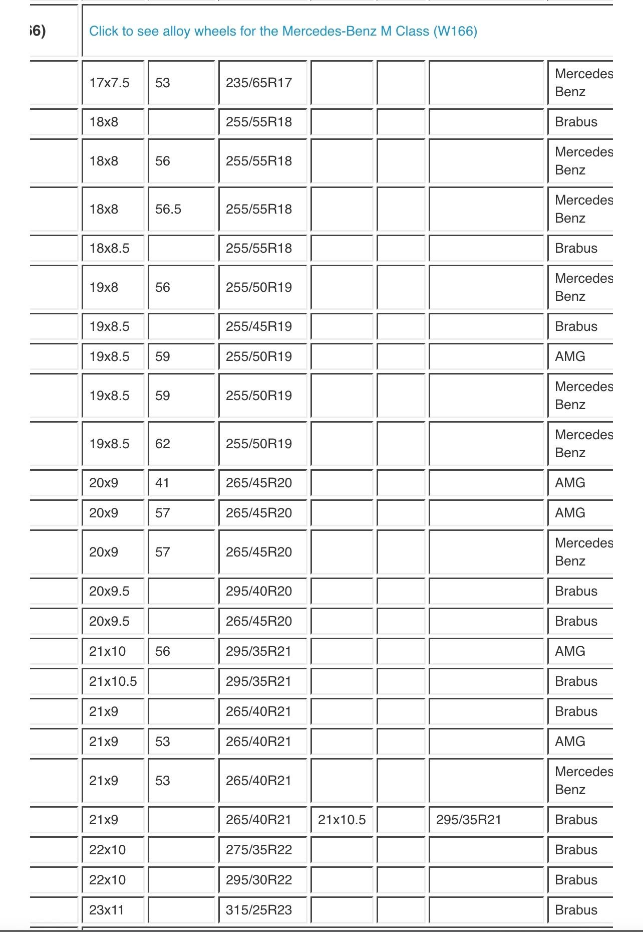

Need a little help.. im doing a little personal project for converting my ml63 to B63 BRABUS so i ordered brabus monoblock 22inch rims for the car and the specs are as follows:
22 x 10 ET 51
  • however what i cant seem to figure out is the tire size i am stuck and cant figure it out brabus recommended 275/35/r22 but i feel the 35 is too narrow and want a perfect look below are pictures of the car and the rim please advise

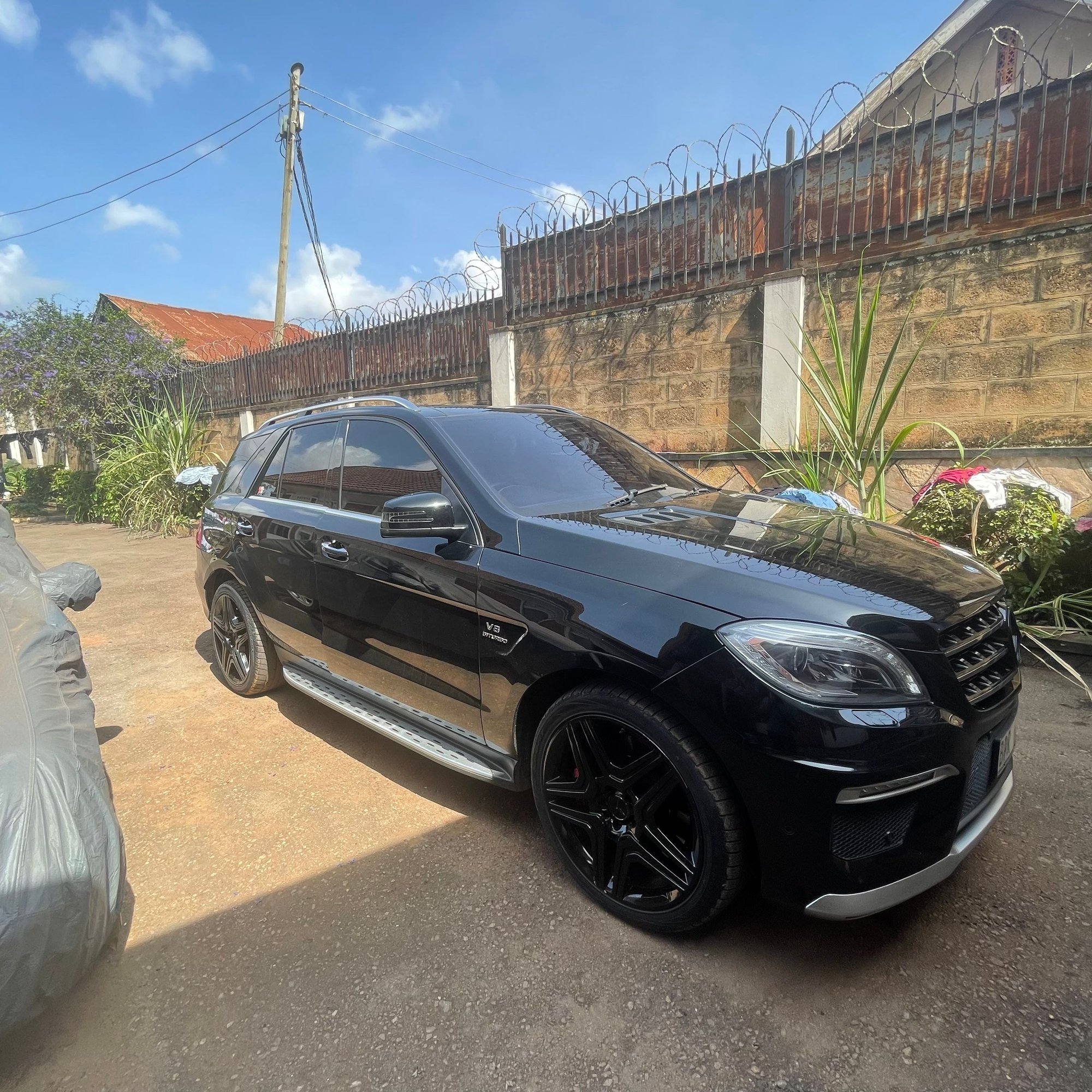

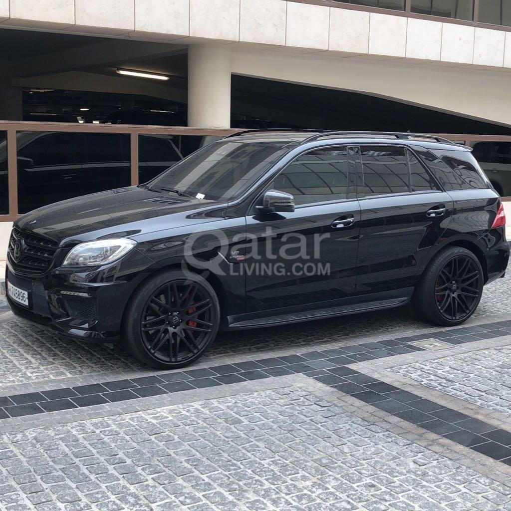

Here are images
This is my car with gloss black 21inch 295/35/r22 project status so far : Stage 1 tune 650hp 850NM Weistec cold air intakes NGK One step colder spark plugs
the car i want it to look like

hey thanks for the advice but i am guessing you just did not know brabus had the 22x10 inch option for ML63 they said the waiting time would be 3 months aswell.

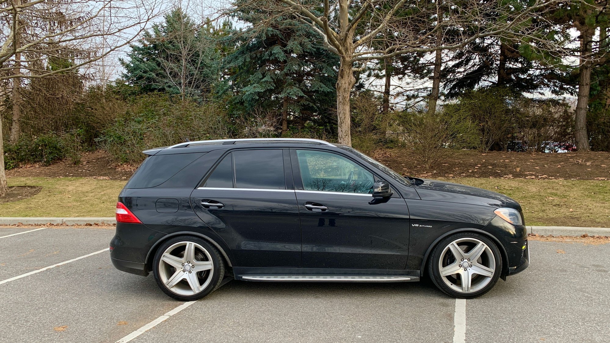

thanks alot so by narrow i meant the profile'35' i saw a '40' and my its huge.. theres a couple of potholes around my work place and the last thing i want is loosing a tire..
yeah I wouldnt want to hit any big potholes with a 35 series although it’s not too bad. I’m in western canada and the roads are pretty good here so I’ve been ok so far.
This is mine on 21x10 AMG wheels and 295/35r21 tires.

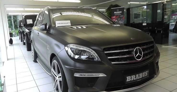

Not sure who supplied you that chart, but I am going to guess it is the dealer selling you that wheel that is NOT a Brabus TUV approved or Brabus manufactured wheel in a 22x10.0.
I worked directly for Brabus dating back to 1999 when they opened their first US operation, and I worked for them on and off up to 2012, and in 2013 after opening my own company I became a Dealer/Distributor for their products.
I can assure you that the wheel you are being presented is NOT a Genuine Brabus wheel or application, so you should take caution as any failure of the wheel is not the responsibility of Brabus, and it is a Tarnish to their brand and name to promote this application as it is 100% not their genuine wheel. The Monobloc F Platinum wheel is a Forged wheel that is only available in a 21, and 23" application.
Also, it is a shame that someone is trying to sell you something under the premise that it is a genuine part that comes from a Premium brand, and it is in fact not at all worthy of the Premium price tag or Brand recognition.
Just letting you know. If you go to BRABUS.DE and go into Tuning, go to the GLE 167 Platform as that is the only current chassis similar to the ML and you will see the wheel applications listed, and that wheel you are claiming to be a Brabus is no where on their site.
That vehicle you posted in their showroom is fit with the Brabus Monobloc G, another Platinum Edition forged wheel, and that wheel does in fact come in a 22x10.0, ET65, that is then fit with the Brabus Spacer Adapter kit like all Brabus wheels that accommodates the offset of each application, and also uses wider bolt on adapters for Wide Star applications.
Ask your wheel supplier for the wheel part number, then call Brabus direct and ask them to confirm that part in their product lineup and I guarantee you that you will discover it is not a Brabus wheel. If you want a Brabus 22x10, the offer the G, which is a forged wheel, but they do also offer the Mono R in a 22x10 cast version that is more affordable, but still $1,895.00 per wheel. If that wheel that is a F copy is priced anything lower than $1,895.00 each, that is also another indicator that it is a Fake!
This is mine on 21x10 AMG wheels and 295/35r21 tires. this looks gooddd although they look more like 22s didn't know the 21 looked this big
i like how yours is sitting low plus the 21s look more like 22s
