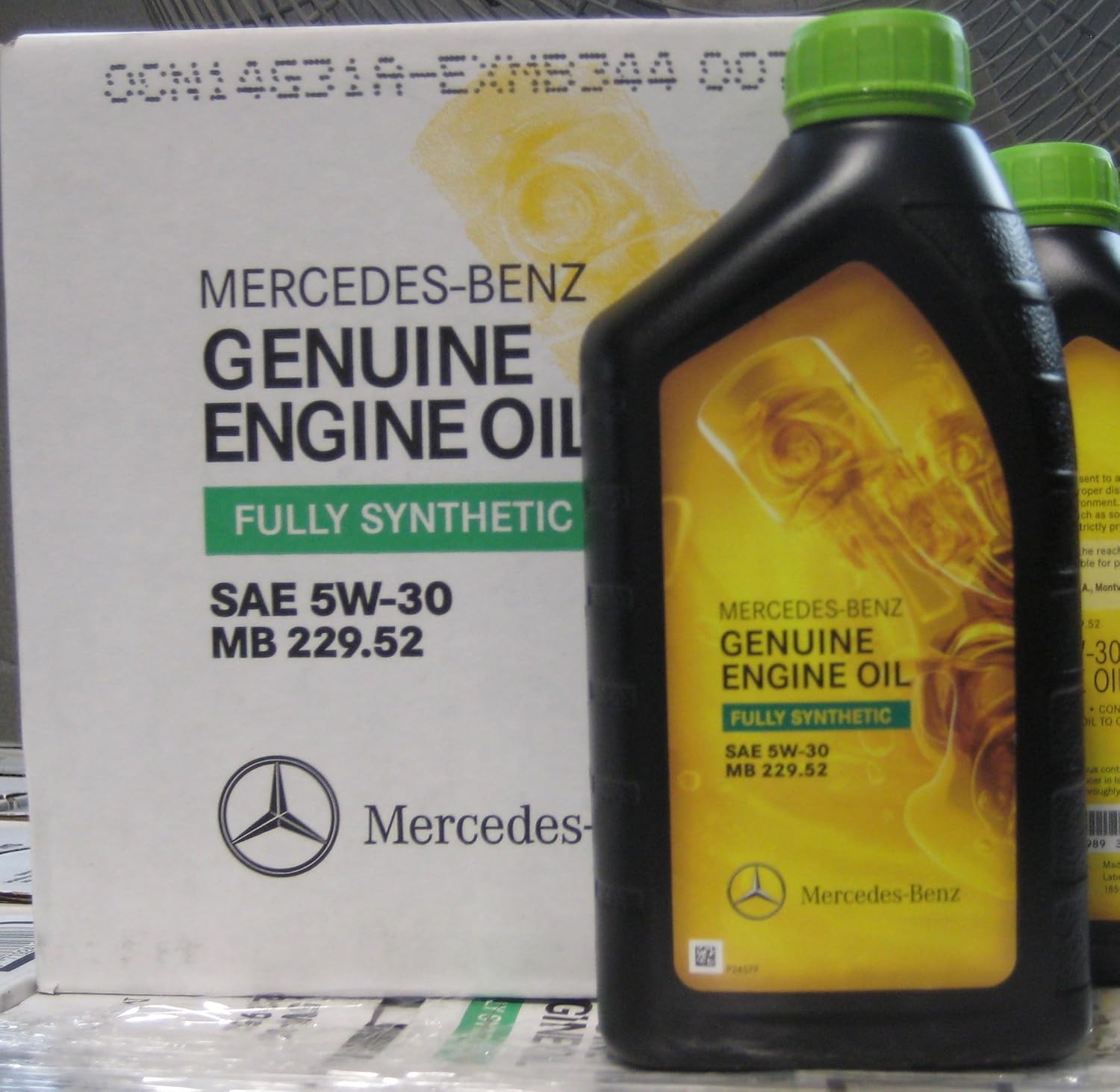

Im using Mobil 1 Part # 001-989-37-01-USA6
Mb Genuine Engine Oil. 229.52
Im getting it from MB dealer.

I gather the "Mobil 1" before the oil part # is a typo. I don't know who makes and/or blends the MB-branded 229.52 oil (the 229.51 one was and probably still is made by Shell), and while not exceptional, they are at least decent.
Despite the long service life claims, 229.52 oils offer a somewhat shorter "realistic" change intervals than 229.51 oils, but if you keep the oil in service for only 5K miles you're not going to wear out the additives or dilute it to the point where you're compromising on engine protection so you're good. Obviously, doing UOAs is the best way to determine how much life is left in the oil (and have a look at your engine health), so you're way ahead of the curve.

Mind you, if you're in the USA, you do want the 229.52 oils because of your high biodiesel content. We still mostly get the good ole dinosaur juice here.

I have a label under the hood MB approves or recommend Mobil 1 so I thought its made / blended by Mobil 1.
Bottle and case looks like this one
https://images-na.ssl-images-amazon....L._SL1500_.jpg
Hope iron and silicon will get down at the next sample. Will do it at 3K. So worry about what is going on with the engine.
