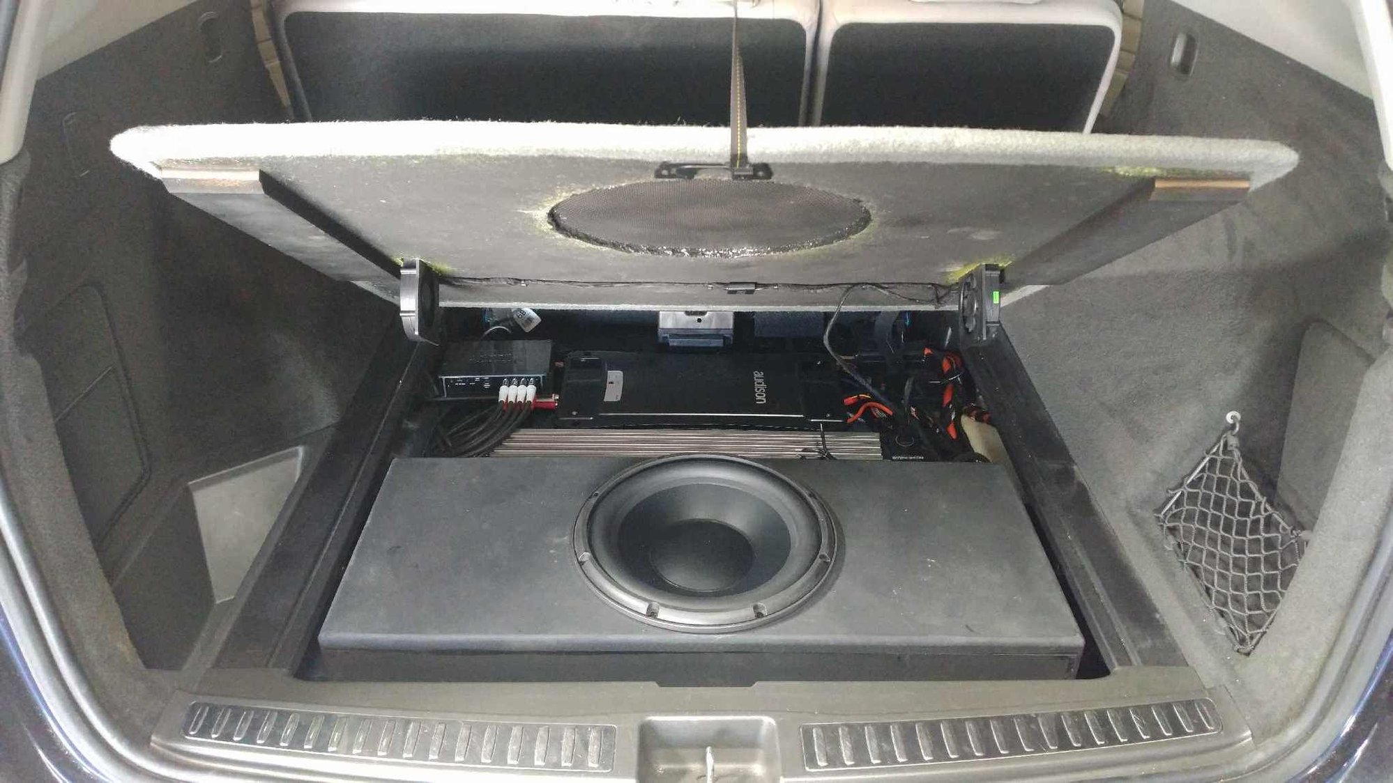

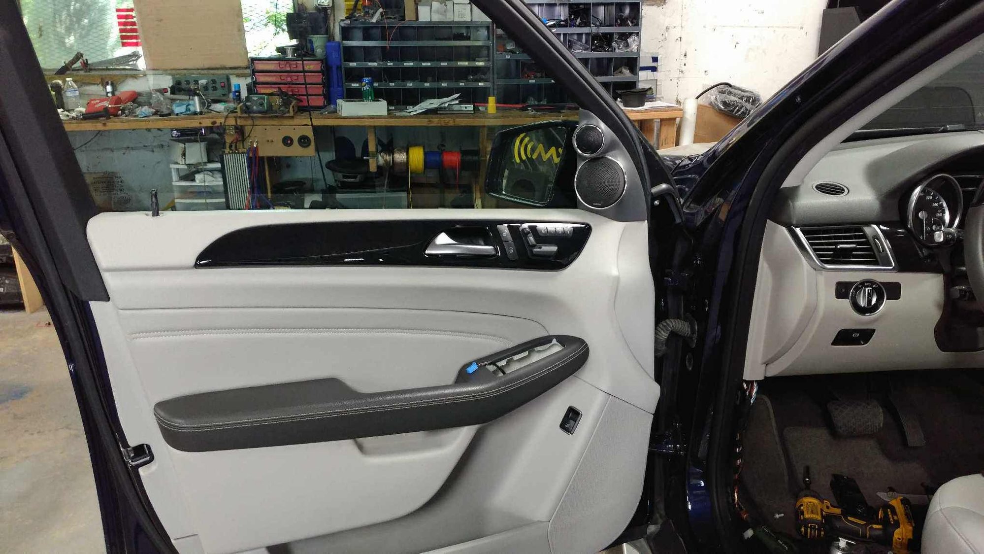

I just finished a SQ install in my 2015 ML350. It sounds absolutely amazing. Looks great too!
Audiofrog GB10 and GB25 installed into custom Sail Panel pods.
Audiofrog GB60 installed into doors

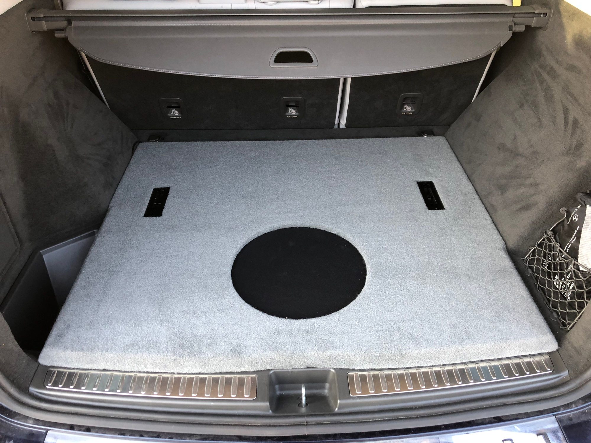

Audiofrog GB12D2 installed into custom box under a false floor
Another view of the Sail Pods
....And another
Zapco Z150.6 LX powering the front stage
Audison Voce Uno powering the Sub
Another view of the false floor with subwoofer box
Helix DSP.2 to correct the speaker response/time align
Mobridge DA1 to intercept factory optical before HK7.1 amp .. fed to Helix DSP
False floor to cover electronics in the wheel well (I'll be redoing the carpet with OEM carpet).
Sound deadening and Closed Cell Foam applied to doors and under the custom sub box.
