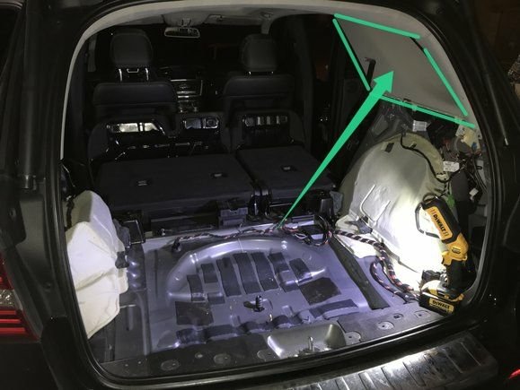

Alright well as you can see I completely disassembled my ML, still can't say with 100% certainty where the noise is coming from, I believe its the shock absorber. I noticed a post in the GLK forums about rear shock noise and how the rubber isolator wears down, thought I had found the problem. Removed the top of my ML shock and found the ML's don't have a rubber isolator its metal on metal with a tiny o-ring between the plate and body. I added a 1/4 inch crushproof rubber washer, no change, I took a video after I added the washers below. I also removed all the covers from underneath the car, gas tank skid, DPF skid, wheel liners. Im at a loss, only reason I still believe its the shock is the noise is so sensitive to any bump (and there wasn't much left on the car to rattle), my tires had been at 28PSI and I aired up to 45PSI for my trip home and this made the noise much more noticeable .... Anyone have any suggestions??

Hey there, I have a 2016 W166 now called the GLE350. I have noticed this noise for the past year and it has been driving me crazy. I can almost guarantee you the rattling is coming from this panel where the rear seat belt goes into. I have not removed it for fear of damaging the panel. But if you would like to try, I assure you the noise of coming from this damn area! You can knock / tap on the panel and hear the rattle. It may be coming from both sides as well. I hear it rattle whenever I go over bumps on the road. Very disappointing quality for a luxury brand.

Never solved a similar issue with my 2019 E450 wagon - traded it out of sheer frustration. I agree with Tomhui above - I always thought it was up in that area around the top anchor of the rear seatbelt.

Hi, It maybe seatbelt unit that rattles like here:
Try fasten the rear left seatbelt and test drive to see any differences in rattle.
