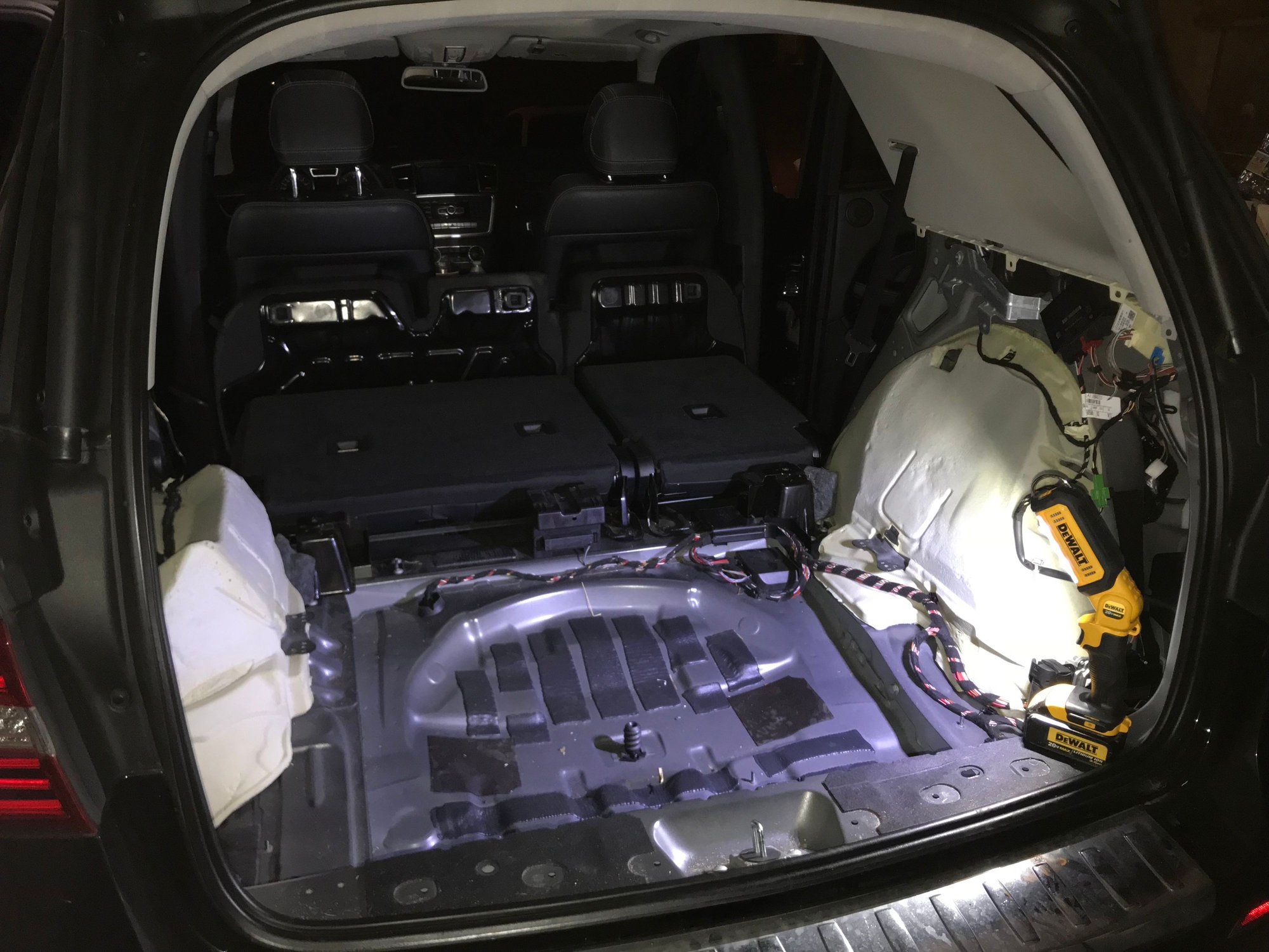

Well all I can say is tomorrow is another day... started working on removing cargo area tonight hoping
maybe I would find the quick fix. Did find multiple loose parts plastic gas tank skid cover, heat shield, plastic speed sensor brackets on both rear control arms. However it wasn't the source of the noise. Whatever is making this noise is very sensitive, the slightest bump will cause the rattle. I’m beginning to wonder if it’s rear shocks or shock mounts. I will check first thing in the morning.

Jesus! When I mentioned emptying the trunk, I meant the spare etc. You've definitely gone the extra mile. Damn!

Alright well as you can see I completely disassembled my ML, still can't say with 100% certainty where the noise is coming from, I believe its the shock absorber. I noticed a post in the GLK forums about rear shock noise and how the rubber isolator wears down, thought I had found the problem. Removed the top of my ML shock and found the ML's don't have a rubber isolator its metal on metal with a tiny o-ring between the plate and body. I added a 1/4 inch crushproof rubber washer, no change, I took a video after I added the washers below. I also removed all the covers from underneath the car, gas tank skid, DPF skid, wheel liners. Im at a loss, only reason I still believe its the shock is the noise is so sensitive to any bump (and there wasn't much left on the car to rattle), my tires had been at 28PSI and I aired up to 45PSI for my trip home and this made the noise much more noticeable .... Anyone have any suggestions??

Damn, I can barely hear it at all. You mean to tell me that with all the under-padding/carpet in place, it's loud enough to hear? That's incredible.
Maybe have someone sitting in the back while you drive to try to isolate where the noise is coming from?

Seriously I can’t beleieve through all the insolation it’s still so noticeable. Go-pro mic sucks. I really don’t want to spend money on OEM shocks, I would want something stiffer.

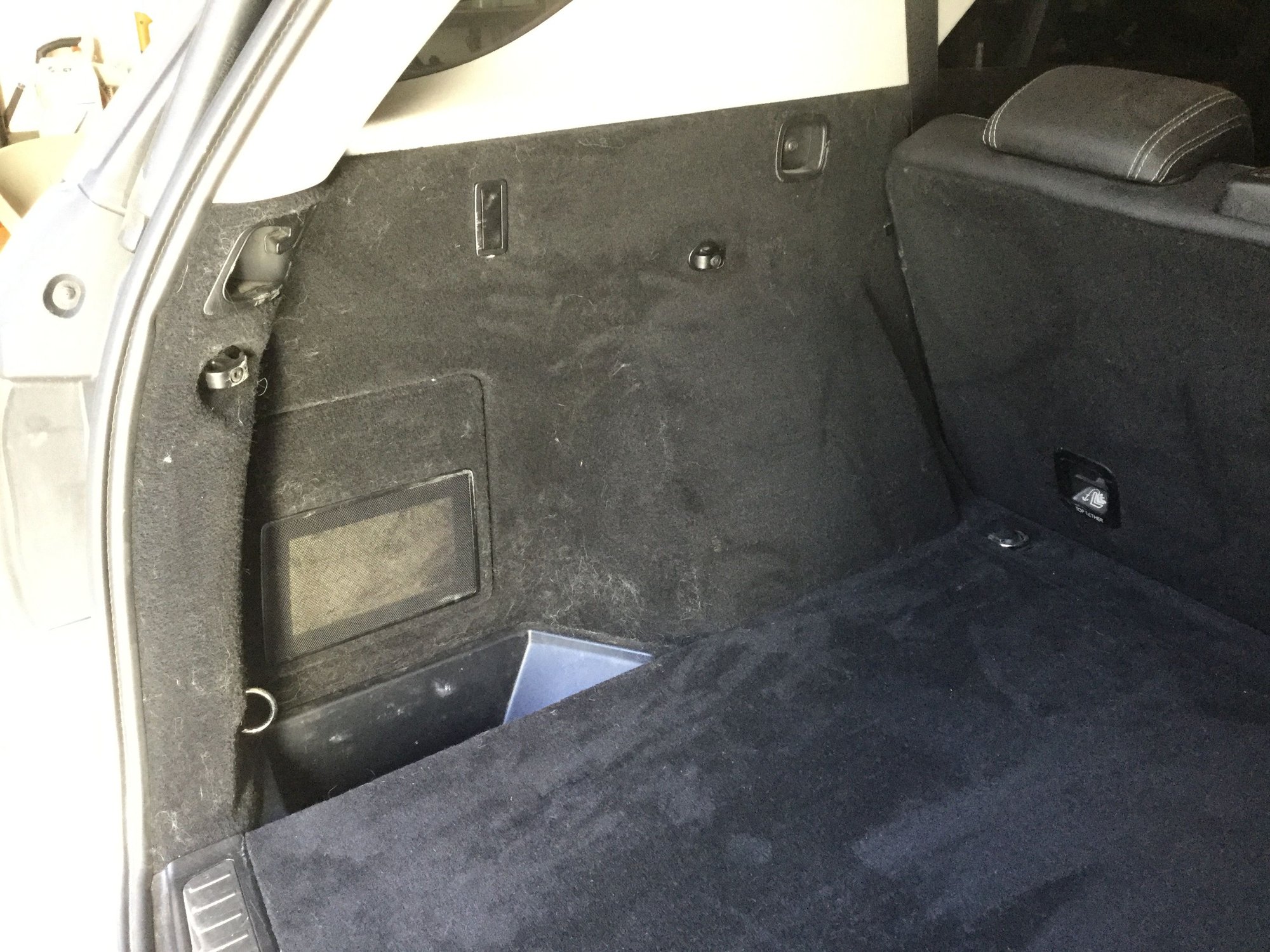

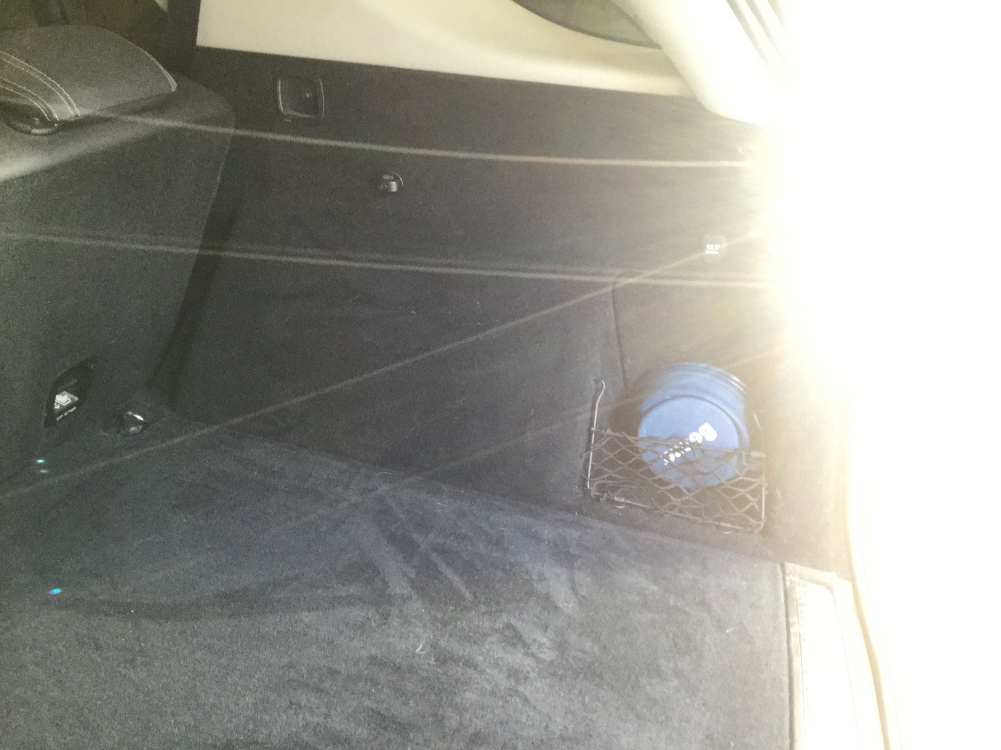

I know this is an old thread, I hope CSM or others are still following. I need to remove both sides of hatch area trim panels, for shock replacement. The shock itself looks very straightforward to replace. Is there a trick to removing the interior panels? I see several torx screws that obviously need removal. the panel looks to be one continues unit from hatch door to the floor of the 2nd row. Thanks in advance. I will continue searching here meanwhile. 2013 ML350 with air suspension and ADS

Can you load a pic of where your taking about? It’s all torx and plastic push pins from what I remember.

Pictures of both sides
CSM Here you go. Thanks!

if I’m remembering correctly the floor has to come out before the side panels will. It’s not hard just take your time and make sure you have a set of torx bits.

Rear escutcheon plate has to come out. You may also describe this as the door sill.
Remove the tie down loops on both sides.
Pretty sure the door seal has to come out as well.
The cargo restraint hooks.
Fold the seats down and the panel pulls off the wall. There are about 5 nylon clips that hold it on and can be a pig to line up again.
Not hard, as advised take your time and it will all go well.
When all back together you need to refit the door seal and ensure it goes over the interior panel.
It's been a while since I had mine apart and I may have missed something.
