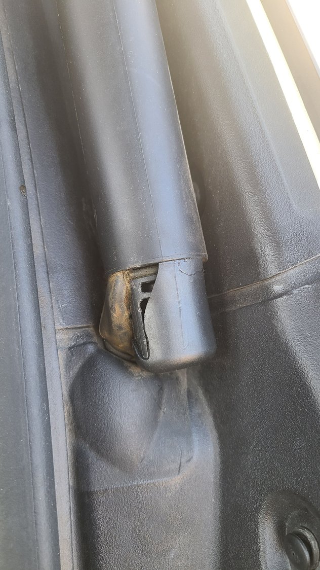

How do you remove the lower struct cover?
Hi there - thanks for the info. My problem (ML350, 2012) is that the right hand side (power strut) lower end clip looks impossible to remove to expose the wire basket you mention. The top is ok, but I've already cracked the lower cover trying to get it off as you can see.
Any tips anyone?

Peter,
I think when I did this in October I just pried those caps off from the side with a screwdriver and they came off in one piece. I think Mercedes must expect you to destroy the caps though because when I got the new gas strut and drive spindle from the dealer they said I needed two new caps for the bottom of the struts as well. I had more trouble getting the wire off the top anchor points, I basically had to destroy the wire to get it out (new struts come with new wires).
Here are part numbers:
001-998-07-21 Right side bottom cap
166-982-07-09 Left side bottom cap
166-890-00-00 Right side drive spindle
166-980-36-64 Left side gas strut
Part numbers have changed for the drive spindle and strut, these numbers aren’t what were on my 2012 ML. They recommended replacing both sides at once. WIS also says that when you replace the old part number with the new one, you need to replace the old gas strut with the new one. I’m not sure what actually changed from the old part numbers, but if replacing both means I may not have to buy them for a while, I figured it was worth it.

UPDATE:
I see what I was doing wrong with the caps - you just need to pry them off by pulling from the middle top and bottom. I was trying to pry them off from the side edges and that's why they cracked.
The end baskets seemed easy ro remove in my case by putting a screwdriver under the center cross wire which lifts the two other wires up. Just three eighths of an inch and the strut releases. Reverse to fit. Also, you're right - that hatch is heavy! I used an adjustable steel pole like the ones to change light bulbs in high ceilings to hold it up.
I fitted both sides which were dated 2011 so I knew both had never been replaced. As folks have mentioned, part of the reason for failure of the power right side is likely a worn left side strut. I saw that myself as the left one was actually shot!
I paid around $50 for the left and $180 for the right from eBay, free shipping. Not OEM Mercedes, so we'll see how long they last! The stealership wanted $1,100 to supply and fit both struts.

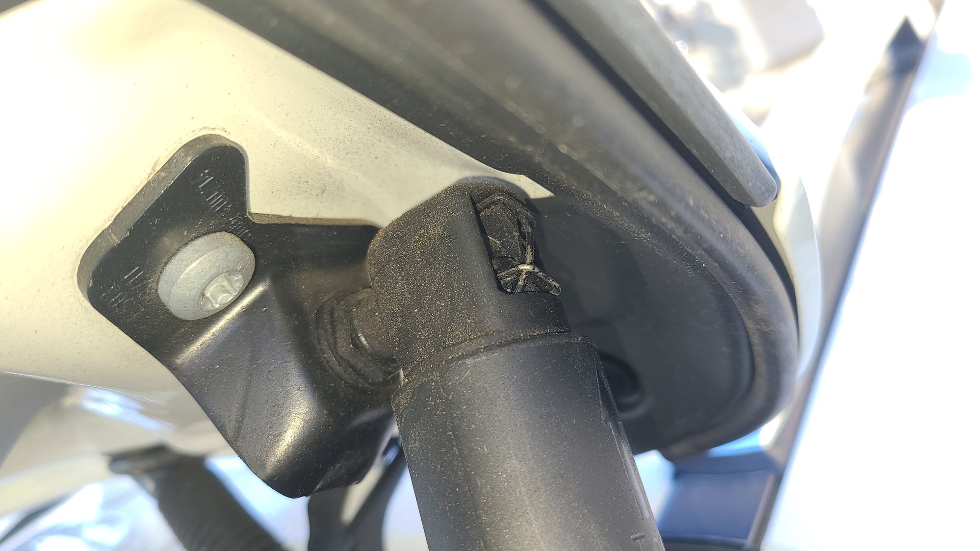

For everyone reading this thread.. some (hopefully) helpful tips:
The left (driver side) strut wears out first. It is a gas strut like on a regular non-powered hatch. The hatch is HEAVY so this strut wears first.
This then puts a lot of strain on the right (passenger) strut.
I noticed my hatch was getting erratic with closing. Almost closing and needing a final push, creaky noises when shutting, etc.
Listened closely and the left strut was making the creaking. Kind of like the two outer plastic covers were rubbing. I actually sprayed lubricant thinking that would fix it. Didn’t do a thing.
Replaced the left strut and all is good again. So definitely check your left strut first! The right strut will stop powering the rear door, but the left strut will cause all kinds of other problems.
Easy to remove..
Open hatch and get a 2x4 to prop it open. Don’t try with a broom stick. Have a 2x4 and maybe cut it to length if required. Have someone hold the 2x4 just to be safe. Hatch is HEAVY and you don’t want it hitting your head!
pull off the lower cap covering the metal clip (you will destroy the cover most likely.. they are cheap to replace)
Grab a pair of needle nose and pull the center piece of wire out from the wire retaining clip. It looks like a wound up wire and you grab the center and pull hard.
You may destroy the wire clip or it may come out just fine. Doesn’t matter because the new strut has new clips.
Do the same at the top
Put the new strut on and push it hard onto the ball mount. The retaining clip will cause it to snap on and stay on. Maybe hit it with the palm of your hand if necessary.
I didn’t have to normalize the door or anything.. just put the new left strut on and everything works perfectly like new!
Also don’t buy aftermarket struts.. have heard they suck. The MB strut is more expensive but you don’t want to have to redo this job again in a year! Lots of aftermarket all over Amazon and Aliexpress and they are all pretty much garbage. Look online for an MB vendor that sells OEM parts cheaper than your local dealer.. there are lots around.

Easy to remove..

Was trying to take my left side strut off to see if it was bad, proactively (see how much pressure it had), released from top ball and mostly slid off fine (btw, the wire doesnt need 2 come completely out just lifted to release the 2 side retaining wires off ball joint) but the top doesnt clear edge of liftgate to come off. Does all of the plastic tailgate trim around that area have to be removed to get the top of strut off? How didd you guys get the top off past the edge of the tailgate?
