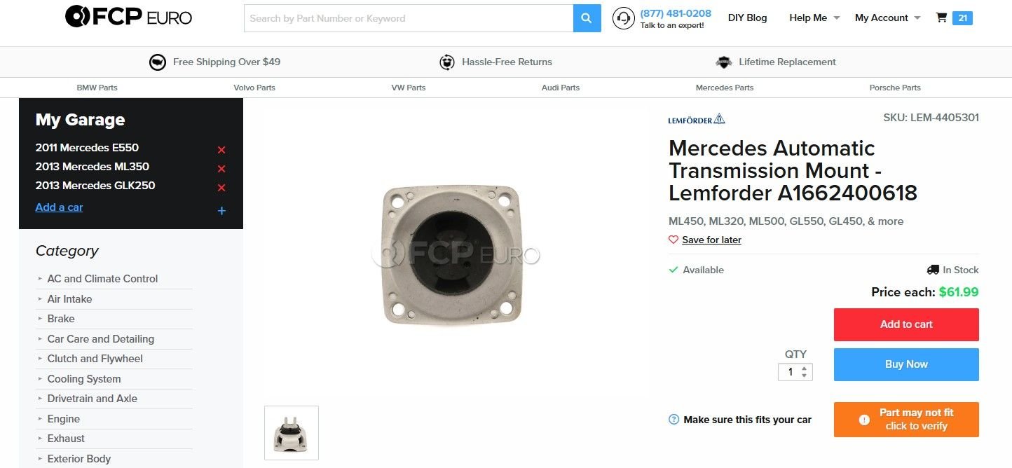

Transmission mount, just something i have to work on later

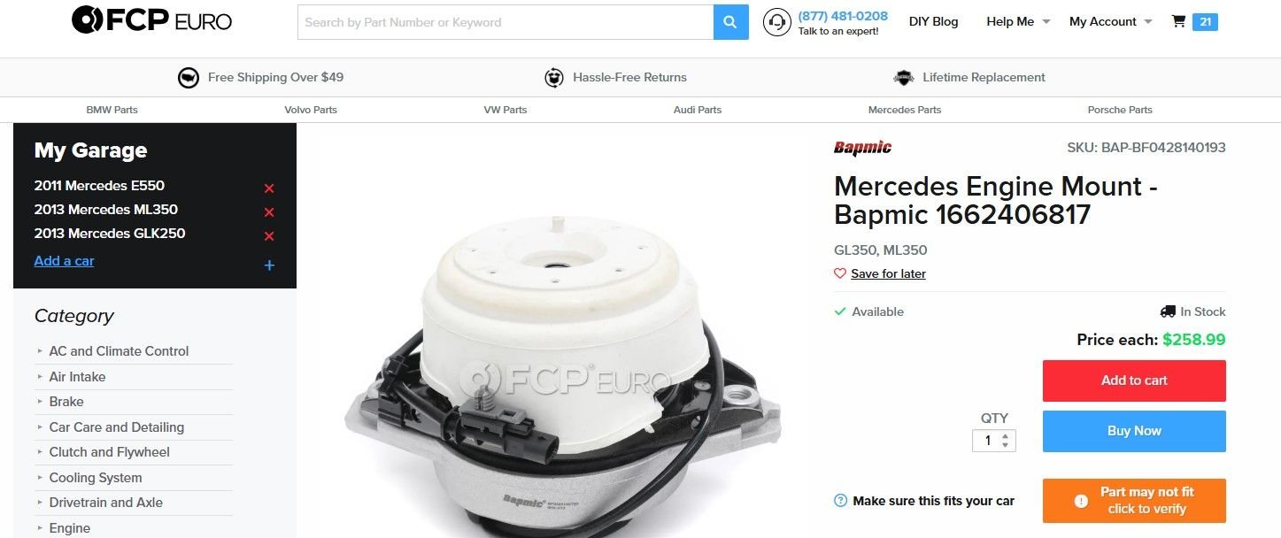

This is the correct engine mount
Cant remember which one is the passenger and which one is the driver. Dont think you can screw it up because there are limited length for the wire connection
