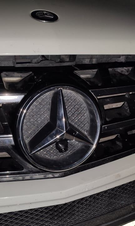

No my car use only rear camera so I changed it by adding bird view with 4 new cameras.

is the bird eye view a kit you buy or did you engineer it yourself. I'm impressed either way since i need this for my ML. I had it on my FX-37 Infiniti and it was a huge step back going to the MB only backup camera. this

A kit I bought from aliexpress.

That is a really nice installation! Thanks for sharing, it's something I'd like to do to modernize my own ML.
