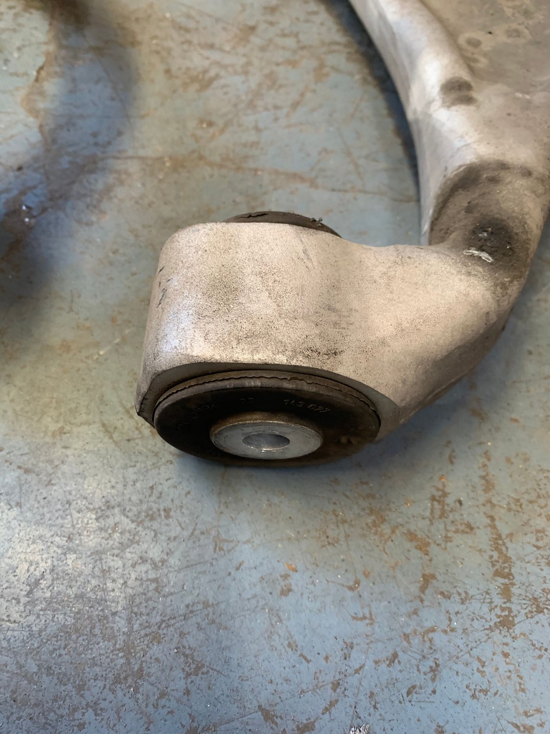

I picked up an 80k 2013 W166 ML350 just recently and had an identical experience. It's obvious that it was sitting in the hot sun outside in southern california because every piece of rubber under the chassis is some form of melted / degraded beyond spec.
I replaced the upper and lower control arms under warranty, as well as the engine mounts, transmission mount, and flex disk.
The control arms fixed the wandering, according to the mechanic the secret is the big ball that carries nearly all the weight of the vehicle in the front. When that rubber ball socket deforms the geometry of the front suspensions starts wandering quite a bit. There is a repair kit for it, but it's not recommended as it's not possible to do it without compromising the long term safety of the control arm. The lower control arms are pricey... ~700 each OEM, and the Lemforders are still half that. But of the things that I had done, it was the biggest safety improvement to the vehicle made after I purchased it a few months ago.
I had the alignment checked before and after, and it was close before but couldn't be corrected to spec until the arms were replaced.
According to the Indy mechanic I had do it under 3rd party warranty (included for free with the vehicle otherwise I wouldn't have touched it, they wanted 5k for 25k miles, so the 90 day 5k warranty for free was a gold mine... got at least that out of it) it's pretty common on Mercedes with a ball on the lower control arm to do this with age; and is not a new phenomenon.
I had the dealership do the engine and transmission mounts, and flex disk as I had a leather seat cover that needed replacement under warranty they didn't have time to do before they sold it. I knew the engine mounts were shot the first time I drove it, and the second time I put it in reverse at a grade I knew the flex disk and transmission mount were shot.
I still have to do the rear bushings and likely replace the 4matic transfer box chain or just pickup a new old stock one and install it (it's got a tiny bit of slack in it from stretch, not slipping teeth yet but it's not 100 percent tight).
Photo of the lower control arm bushing at fault here...

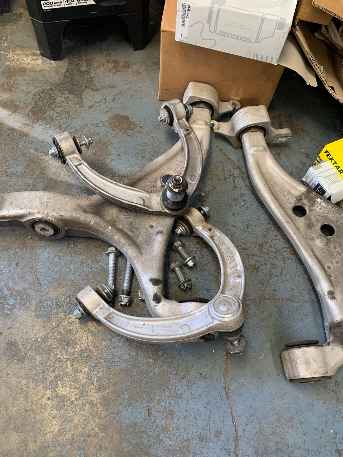

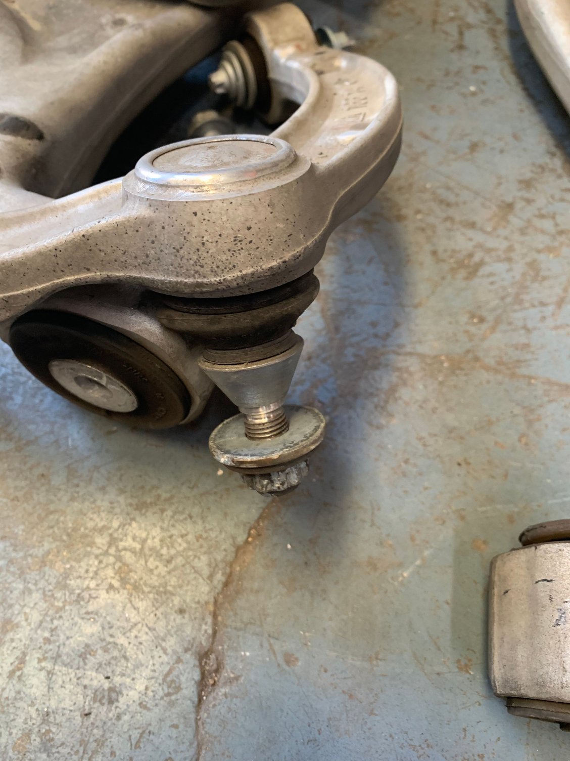

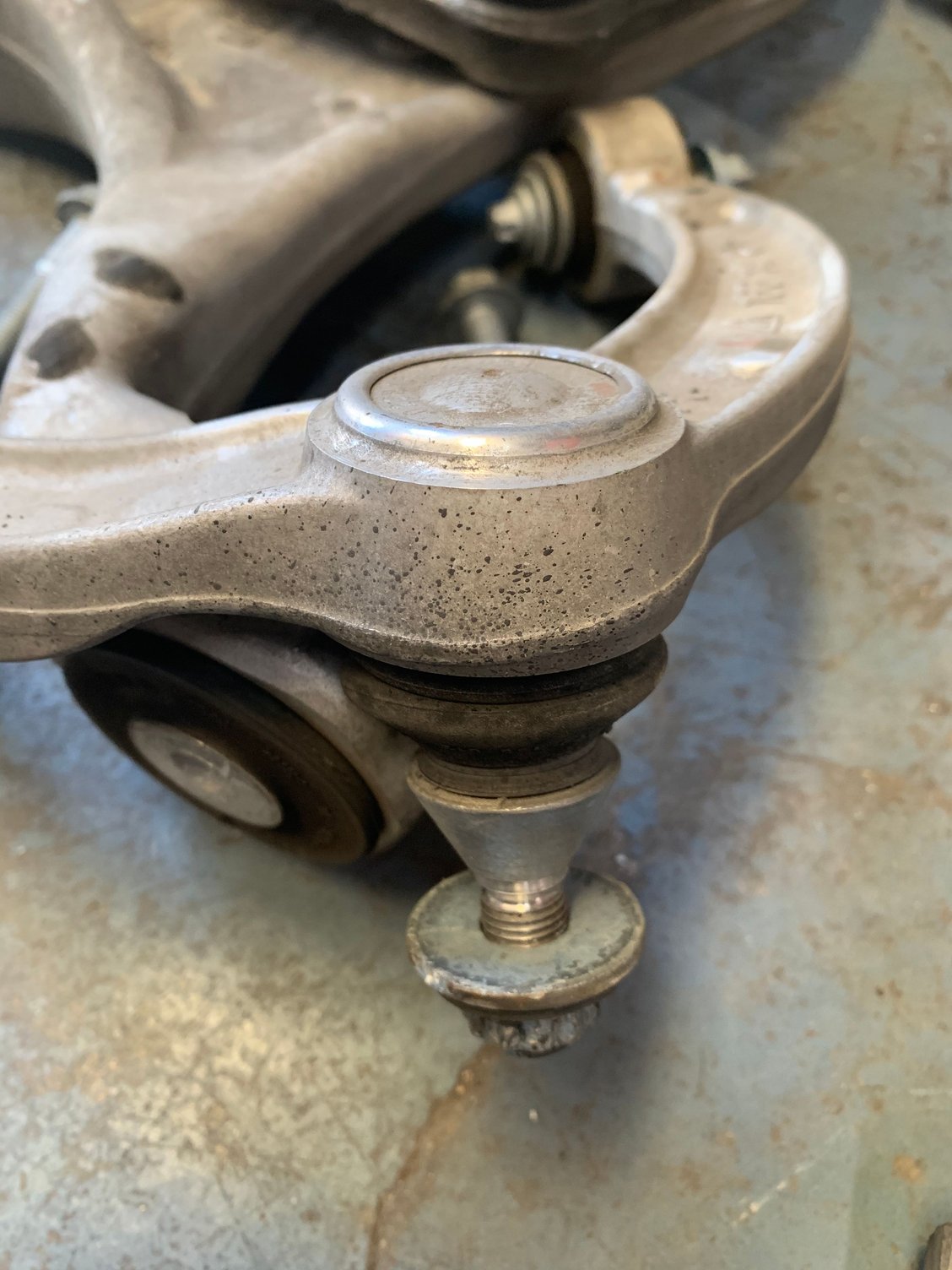

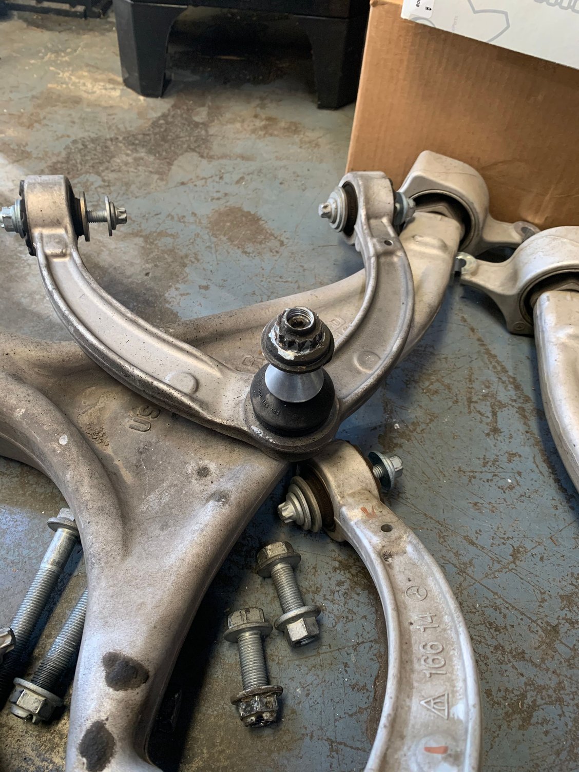

One additional note, I took photos of all the parts after replacement, and the only 2 parts that showed visible and obvious signs of degradation were the flexdisk (there were microfractures on the surface near the bolt holes), and the engine mounts, because they had leaked.
You can't tell the bushings are bad even with it up on a rack trying to wiggle the wheel, there's not enough weight to do any meaningful deformation with your hand. If they're so bad you can tell with your hand; it's a life threatening hazard at that point.
Also, even with the lower control arms out, without cutting the arms or destroying the bushing trying to yank them out you won't be able to really tell either. It's just dry rubber that the elastomers have degraded and it no longer has enough 'spring' left in it.
Check the ***** for the electric power steering knuckle, but they're likely fine. The OEM ball is quite pricey as it's a critical safety component, but Lemforder makes those as well.
If it's 7-10 years old, has been in heat for that long on and off; the rubber is bad.
Time, temperature, and vibration energy causes it. Mostly time and temperature.

The photo is of a factory front lower, it might actually be a w164 and not a w166 but the bushing geometry is identical essentially.
On the rears you can just push out the bushings and replace them as they are cylindrical instead of ball joints.
Honestly the rear the sway bar links are probably suspect. I know mine are squeaky if I go over big speed bumps when it’s over 90F. They are cheap and reasonably easy to replace but likely wouldn’t explain the wandering unless the rear end is so bouncy that it’s literally floating off the road. Wandering in the lane though is nearly always front end drift. Small geometry changes can make big directional changes if the camber and toe are drifting all over the place in the front.
Essentially you have a floating box on your front wheels and there is rubber on every mount point of that box. Once the rubber gets weak the box wobbles all over the place. My lower bushings were definitely hard but honestly other than surface smoothness a screw driver won’t tell you much other than damaging the rubber further. If you live somewhere where the roads are rough, that rubber is toast after 3/4 of a decade and many many miles.
If you’ve ever seen those square rubber blocks under electronics from the 80’s that turn to goo over time, we’re essentially seeing the same effect just the elastomers aren’t holding the rubber together, rather they’re keeping it tight and able to maintain geometry vs sag and float all over the place as it takes suspension forces.
I think the biggest thing to keep in mind here is the ML is BIG and HEAVY compared to the cars that Mercedes builds. So while they may get 100k out of the same component and a decade plus, that same suspension component takes dramatically more punishment on our big heavy SUV’s. It’s why Toyota Tundra 4x4 et al’s have a fraction of the rubber in the drive line. It just dies a brutal death by a thousand bumps and temperature swings and age.
The Lemforder lowers are fine. I just used OEM since warranty was paying instead of me.
These were the factory front arms that came out of my ML350. As you can see the rubber is hard to diagnose by look. I can attest though that it went from scary to near factory feel with four parts. I did order all fresh bolts for safety though and had them all torqued to factory spec.
